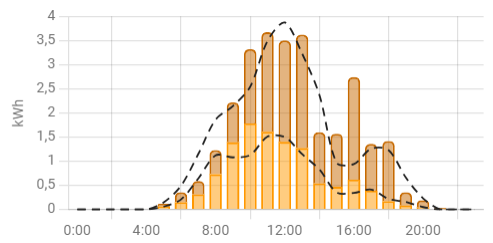

Hi, just wanted to share my to experience with Open-Meteo Solar Forecast. I originally was using Forecast Solar (good at the beginning, wildly unusable later) and Solcast (solid). Now, the Open-Meteo Solar forecast is giving me very accurate predictions (Czechia).
I mean it can’t be much better than this, right? It’s from couple of days ago. (There’s a tree casting shadow over my east string in the morning).
This is from today.
All in all, great integration and many thanks for your work! Much appreciated!
