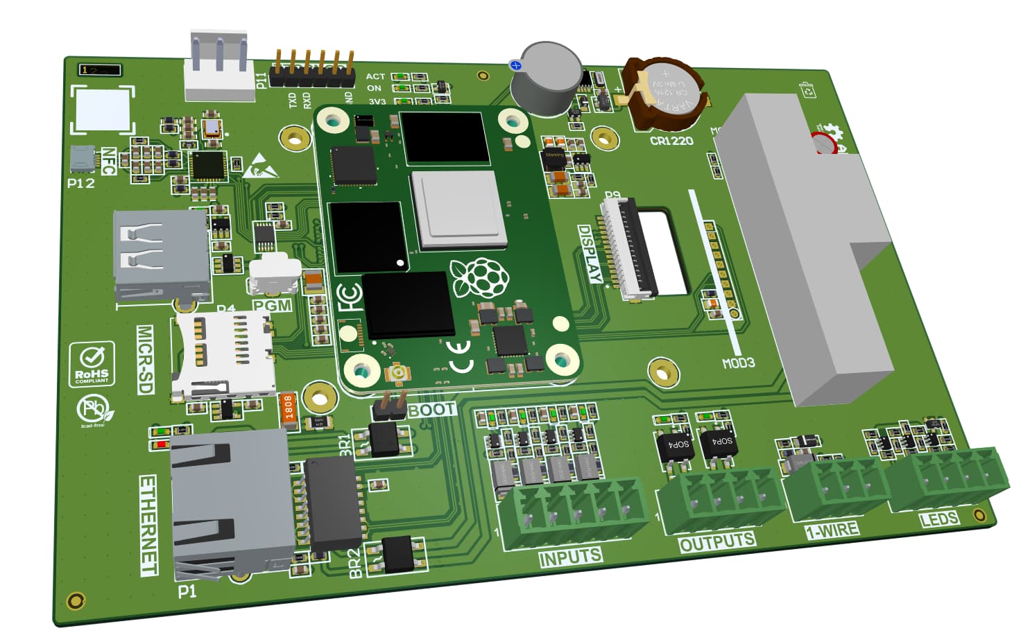

I just finisehd an open-source board in order to run HA with different peripherals. Included:
  1. Direct rapsberry 7" TFT with touch + power supply
  2. POE power supply
  3. RJ45 Ethernet
  4. NFC reader
  5. PCF85063 + CR1216/1220 RTC
  6. Micro-SD
  7. USB host
  8. USB device with automatic switch for eMMC flashing
  9. 4 wide range isolated digital inputs
  10. 2 photo-mos digital outputs
  11. 1-wire bus
  12. 100mA RGB led drive
  13. FTDI type console UART
  14. RX22 433MHz radio
  15. Buzzer
  16. Main +3V3 can be fed through local DCDC if required
I am happy to share if someone is interested.
