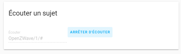

So if you go to the developer tools in Home Assistant and hit the MQTT tab and enter “OpenZWave/1/#” into the topic to subscribe to
and hit Start Listening
do you see anything?
I see nothing
