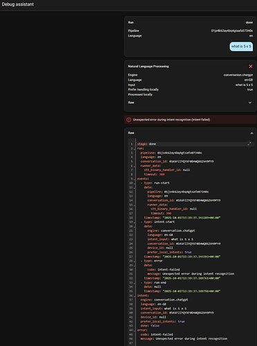

Hi all
I restarted my HA server after some integration updates (nothing to do with OpenAI). After then I keep getting errors with my conversation assistant.
I’ve read a bit on others having this issue but most seem to stem from an incompatible model being used. I’ve run through some problem finding steps with OpenAI (ensuring the used 4o-mini model is allowed and account still functioning) and also attempted to use other models but get the same result. I tried the extended openai conversation agent and that is working but doesn’t seem as reliable as the standard (e.g. can’t dynamically set a timer by listing the target time instead of duration).
I don’t know what to do next. Can anyone help?

Also I can’t read that screenie in my phone
Paste text not a screenshot inside a codeblock (/) on the menu

The code from my initial post is below:
stage: done
run:
  pipeline: 01js4k62ay4bq4gtsafx07340x
  language: en
  conversation_id: 01K6FZZYQYXF0DHWQ8G2VH9PY9
  runner_data:
    stt_binary_handler_id: null
    timeout: 300
events:
  - type: run-start
      language: en
      runner_data:
        timeout: 300
    timestamp: "2025-10-01T13:39:37.343289+00:00"
  - type: intent-start
      engine: conversation.chatgpt
      language: en-GB
      intent_input: what is 5 x 5
      device_id: null
      prefer_local_intents: true
    timestamp: "2025-10-01T13:39:37.343393+00:00"
  - type: error
      code: intent-failed
      message: Unexpected error during intent recognition
    timestamp: "2025-10-01T13:39:37.389761+00:00"
  - type: run-end
    data: null
    timestamp: "2025-10-01T13:39:37.389798+00:00"
intent:
  language: en-GB
  device_id: null
  done: false
error:
  code: intent-failed
  message: Unexpected error during intent recognition`Preformatted text`
