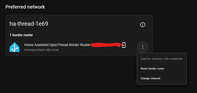

In the HA App under Preferred network the "Used for Android + iOS credentials" is greyed out.

In the HA companion app do the following.
Open settings.
Open companion app.
Open troubleshooting.
Click sync Thread credentials.
