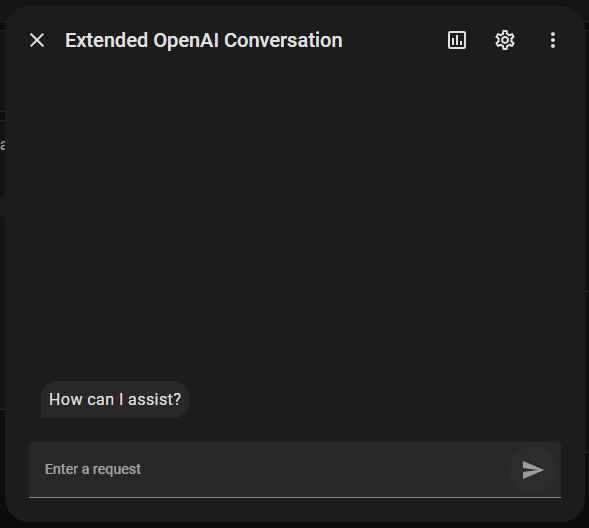

Integrating OpenClaw with Home Assistant Assist pipeline is now possible.
This gives you the ability to use OpenClaw in the Home Assistant Assist card on any of your dashboards. Thanks to the extended_openai_conversation integration we can easily connect it with HA.
This is much more secure than providing HA token to OpenClaw because allows you expose only selected list of entities to the AI agent.
The OpenClaw gateway already exposes OpenAI like API and we just enable it, then eveything is just configurations on the Extended OpenAI integration side. Voice mode should be also possible once configured in HA.
How to configure it: OpenClawHomeAssistant/DOCS.md at 57d0a588ac03673a9a440f3cf77067834d624eb5 · techartdev/OpenClawHomeAssistant · GitHub
