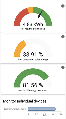

I have an emonpi from https://openenergymonitor.org/ for tracking solar PV + home energy usage, and I’m on Octopus Go variable rate tariff, neither of which were entirely straight forward to add to the Energy dashboard, and as no one else appears to have done so I thought I’d share my config here

Since posting the article here I did stop using the ‘platform: integration’ to calculate Energy readings from the Power, and instead have emonpi broadcast energy readings on their own topics. Relevant udpated HA config below.
One thing that proved a real PITA is whenever the emonpi is reset the meter readings reset to zero, and this seems to make HA Energy dashboard think there’s been a massive negative usage of power on that day, and trying to “clean” the HA database up to remove these negative reads involves a lot of splunking about in the SQL add on. The docs say that energy meters going backward should be autodetected as a meter reset and in essence ignored, but my experience so far is that is not so good!
Final note: Octopus increased the SEG outgoing rate to 7.5p yesterday, so I better update the dashboard to use that now! Outgoing Octopus | Octopus Energy (Maybe one day I’ll actually pull this via their API…)
