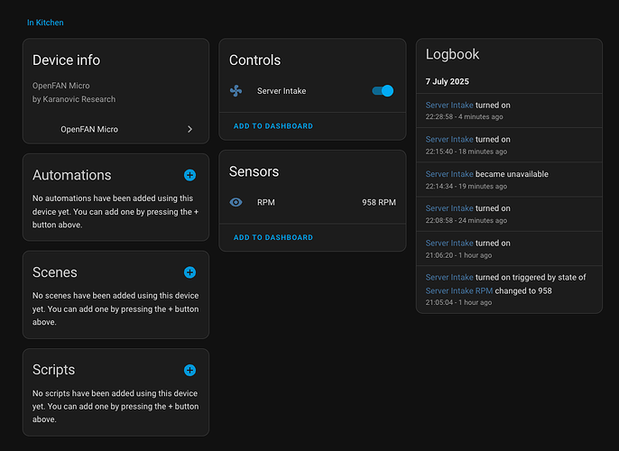

Based on the configuration above I’ve created this custom component for the OpenFAN micro: GitHub - BeryJu/hass-openfan-micro
This has an entity for fan control (as a proper fan entity) and a sensor for RPM speed so you could also alert when fan speed >0% and RPM == 0 if the fan is blocked for example:

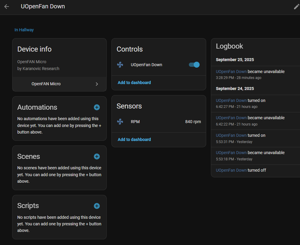

Sadly this does not work anymore.
Only creates a device called uOpenFan and no entities.
As stated here:

bitlisz
(Bitlisz)
September 25, 2025, 1:55pm
6

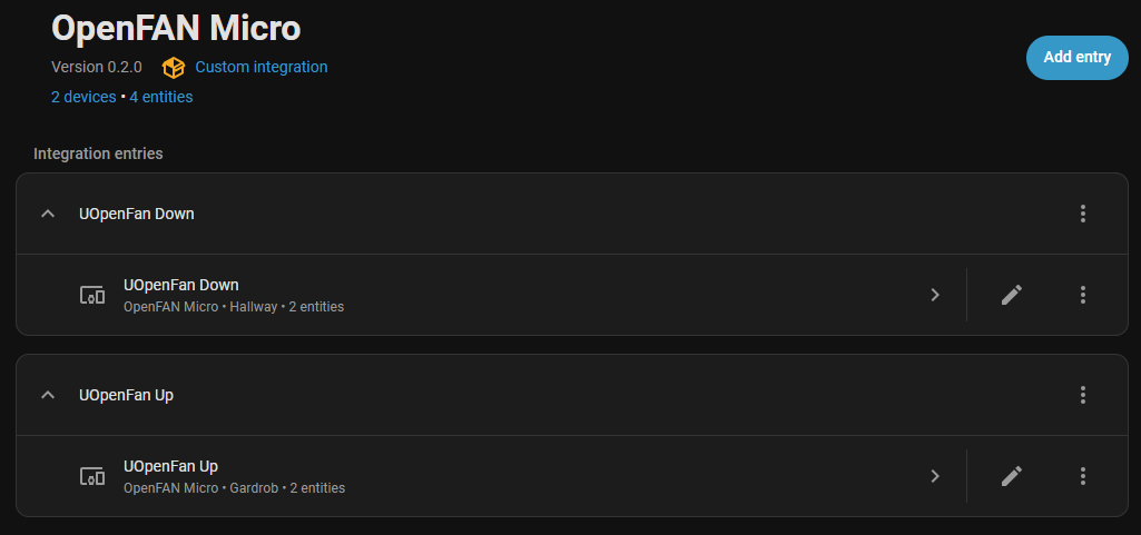

@BeryJu I hope you don’t mind - with the help of AI - created a fork from your repository:
Contribute to bitlisz1/hass-openfan-micro development by creating an account on GitHub.
Tested and working with 2 micros:
