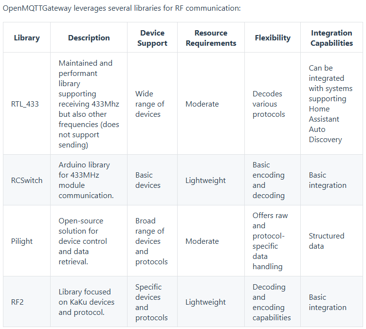

The LORA component supports receive and transmit, but the RTL433 component that OMG uses is receive-only…
The question, really, is whether or not OpenMQTTGateway is able to manage two transceivers on the same board.
It depends which library you wanna use with OpenMQTTGateway
