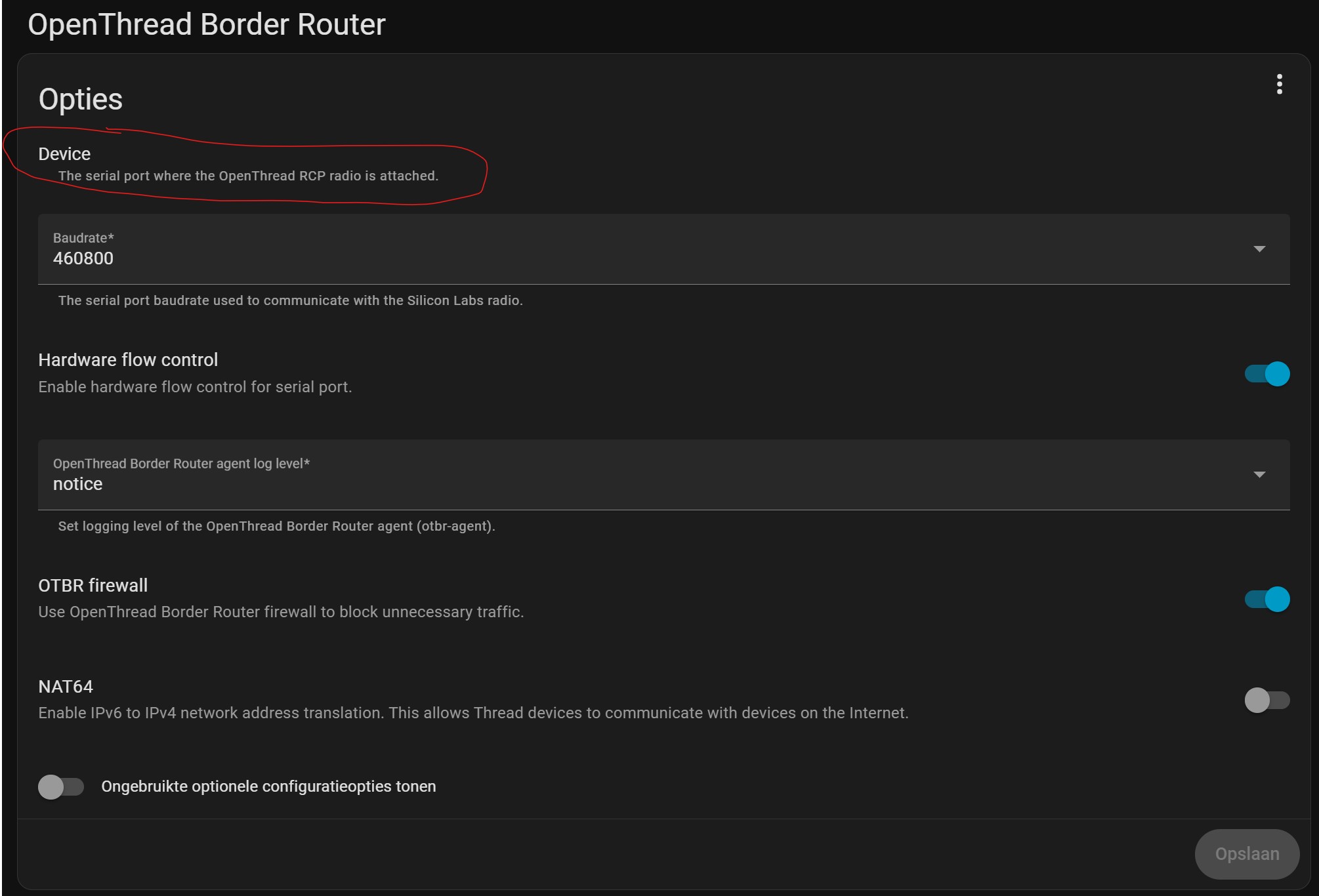

Today i installed my SLZB-MR3U. Zigbee 2 MQTT runs just fine on it. Now I am trying to setup the OpenThread Border Router but this gives me some headaches
In the configuration i am aware that i have to select a dummy device but no devices are listed (see the image). So my question is how to fix this.
So if someone could give some instructions here i would be really greatfull.

Since this is a IP based device, I think you want to click the switch “Show unused optional configuration options” Under NAT64. Yours appears to be in your native language.
That should then show the field for host:port to get it to communicate with your MR3U. I suspect that field only populates if it recognizes a USB device that might work. It would be nice if it told you that it didn’t find any instead of just blank, but this is all pretty new.

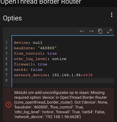

Hi Travis, Thanks for your reply. I did at some point switched the switch a filled in the IP address and port (192.168.1.96:6638). But at this point I cannot save the configuration. The error ‘missing required option device’ pops up.
Maybe someone can paste his yaml from his configuration. Mine looks like this:
Thanks again
I have connected a esp8266 to a usb port. Now I can select it as a device in the configuration and make the necessary settings. Now it is working so far
