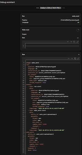

The voice assistant debug pipeline looks like its stuck at wake_word. What should I do next to resolve this? Any pointers would be much appreciated.

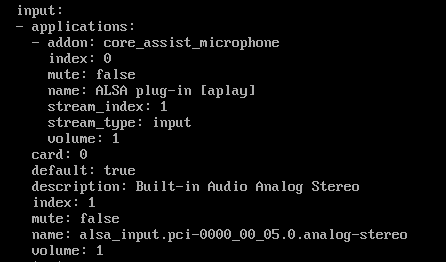

  3. in HAOS, ha audio info returns no issue. It sees the mic, all configuration is ok.
  4. Then I performed ha audio volume input --index 1 --mute and then ha audio volume input --index 1 --unmute and then restart assist-microphone addon, all works fine with the customized awake WAV now.
