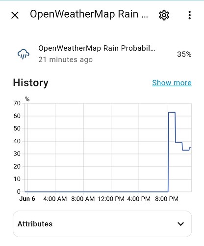

After a lot of trial and error, I finally figured out how to pull precipitation_probability from OpenWeatherMap, so I thought I’d share. This is the sensor I added to my configuration.yaml to get it to work after adding the OpenWeatherMap. It checks every 15 minutes, but you can adjust that.
I was thinking the same. Creating a sensor that will tell me if it will rain soon. So this sensor fetch precipitation_probability 1 hour from now and update every 15 minutes?
After posting this, I read your sensor name and it did say next hour. oops.
@imadethem do you also get the error message on the “time_pattern” line?
(it does work, however. just that configuration.yaml is in red)
No error in my configuration.yaml file using that time_pattern line, odd. I am using home assistant green, and I’m fairly new to HA in general, so I’m not sure if the system could be causing differences
If you copy and paste the code, delete it and type it manually. I find that HA somethings throws error even it the code looks correct.
