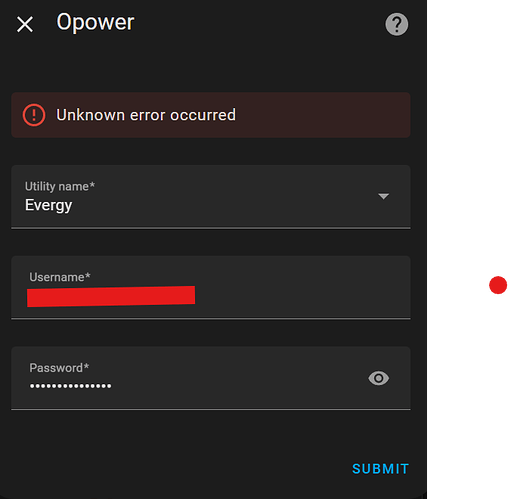

Opower Evergy Unknown Error at setup
Trying to set up OPower for Evergy, but it just throws “Unknown error occurred”
I can log into Evergy web page no problem.
No idea where to go to troubleshoot this.
Ideas?
Core Log:
Logger: aiohttp.server
Source: /usr/local/lib/python3.13/site-packages/aiohttp/web_protocol.py:481
First occurred: 8:43:04 PM (9 occurrences)
Last logged: 9:21:53 PM
Error handling request from 172.28.3.2
  File "/usr/local/lib/python3.13/site-packages/aiohttp/web_protocol.py", line 510, in _handle_request
    resp = await request_handler(request)
  File "/usr/local/lib/python3.13/site-packages/aiohttp/web_app.py", line 569, in _handle
    return await handler(request)
  File "/usr/local/lib/python3.13/site-packages/aiohttp/web_middlewares.py", line 117, in impl
  File "/usr/src/homeassistant/homeassistant/components/http/security_filter.py", line 92, in security_filter_middleware
  File "/usr/src/homeassistant/homeassistant/components/http/forwarded.py", line 83, in forwarded_middleware
  File "/usr/src/homeassistant/homeassistant/components/http/request_context.py", line 26, in request_context_middleware
  File "/usr/src/homeassistant/homeassistant/components/http/ban.py", line 86, in ban_middleware
  File "/usr/src/homeassistant/homeassistant/components/http/auth.py", line 242, in auth_middleware
  File "/usr/src/homeassistant/homeassistant/components/http/headers.py", line 41, in headers_middleware
    response = await handler(request)
  File "/usr/src/homeassistant/homeassistant/helpers/http.py", line 73, in handle
    result = await handler(request, **request.match_info)
  File "/usr/src/homeassistant/homeassistant/components/http/decorators.py", line 83, in with_admin
    return await func(self, request, *args, **kwargs)
  File "/usr/src/homeassistant/homeassistant/components/config/config_entries.py", line 227, in post
    return await super().post(request, flow_id)
  File "/usr/src/homeassistant/homeassistant/components/http/data_validator.py", line 74, in wrapper
    return await method(view, request, data, *args, **kwargs)
  File "/usr/src/homeassistant/homeassistant/helpers/data_entry_flow.py", line 121, in post
    result = await self._flow_mgr.async_configure(flow_id, data)
  File "/usr/src/homeassistant/homeassistant/data_entry_flow.py", line 336, in async_configure
    result = await self._async_configure(flow_id, user_input)
  File "/usr/src/homeassistant/homeassistant/data_entry_flow.py", line 383, in _async_configure
    result = await self._async_handle_step(
        flow, cur_step["step_id"], user_input
  File "/usr/src/homeassistant/homeassistant/data_entry_flow.py", line 487, in _async_handle_step
    result: _FlowResultT = await getattr(flow, method)(user_input)
  File "/usr/src/homeassistant/homeassistant/components/opower/config_flow.py", line 88, in async_step_user
    errors = await _validate_login(self.hass, user_input)
  File "/usr/src/homeassistant/homeassistant/components/opower/config_flow.py", line 51, in _validate_login
    await api.async_login()
  File "/usr/local/lib/python3.13/site-packages/opower/opower.py", line 200, in async_login
    self.access_token = await self.utility.async_login(
        self.session, self.username, self.password, self.optional_mfa_secret
  File "/usr/local/lib/python3.13/site-packages/opower/utilities/evergy.py", line 70, in async_login
    login_parser.verification_token
AssertionError: Failed to parse login verification token
