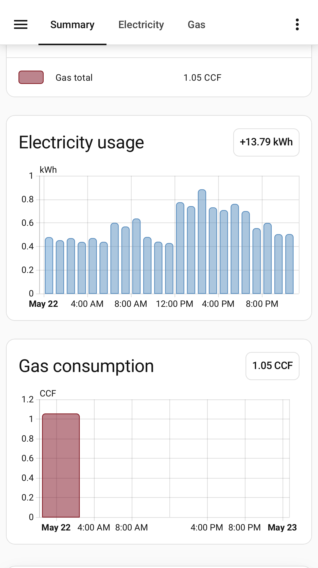

Do you know why PG&E reports the gas usage once at 12AM everyday?
