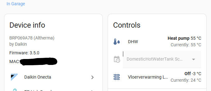

    Based on my understanding, my biggest finding is that you have 2 controls when activating the HA integration: one for DHW and one for underfloorheating.

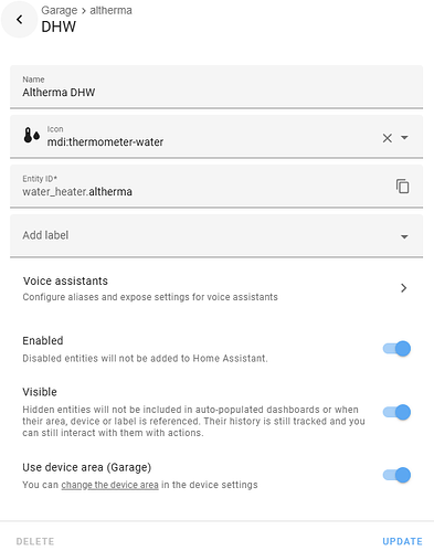

    The confusing thing of the standard integration (at least in my installation) is that the first one does not seem to come up very clearly in HA as a thermostat, causing some inital confusion at my side as well (also due to the naming). In order to distinguish, I changed the naming & the logo in my HA instance:

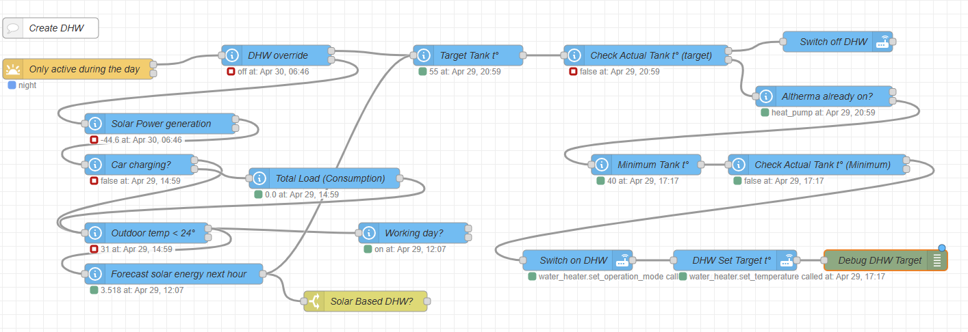

  3. Once this was done, I used Node-Red to build my flow. It’s still quite rudimental, and for sure will be improved the coming weeks, but I hope it gives you an idea:
The Node-Red flow hopefully/probably explains itself a bit. You’ll also notice there are still some blocks that still represent ideas (e.g. consider the forecasted solar power, differentiate on week days vs. working days) that I still need to consider in my logic. This is on my schedule the coming weeks.

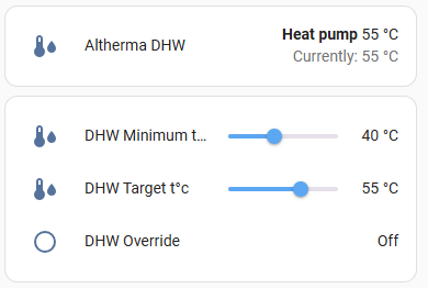

In order to steer this process, I’ve created 3 helpers in the flow (that I also include on my dashboard):
  • “Minimum t°” is the lower boundary; I’ll only start creating hot water if it drops below that threshold. This to make sure I don’t end up in an on/off cycle.
  • “Target t°” speaks for itself.

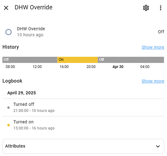

  • “DHW override”: as you can see in the flow, when this is enabled, it skips all logic. This is a “times of the day” implementation just to make sure that I have hot water in the evening (e.g. during the winter days):

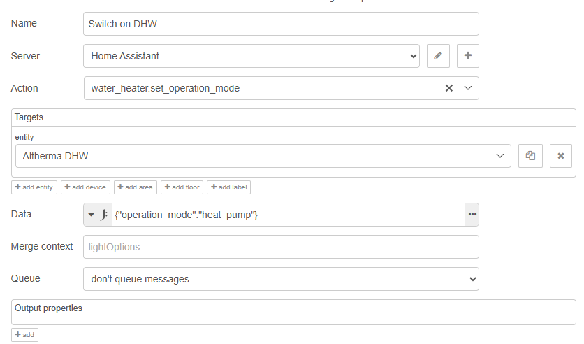

  • Switching on the heatpump for DHW is configured like this:
    Simply replacing the “heat_pump” by “off” in a copied node switches it off again.

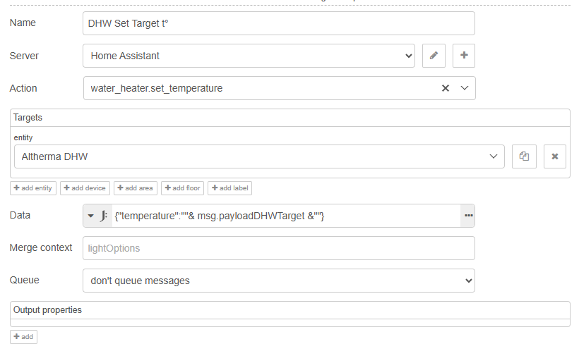

  • Setting the tank temperature is done like this:
    The t° value is now coming from the above helper that is read out earlier in the process (and stored in the msg), but if you want, you can also hardcode this yourself.
