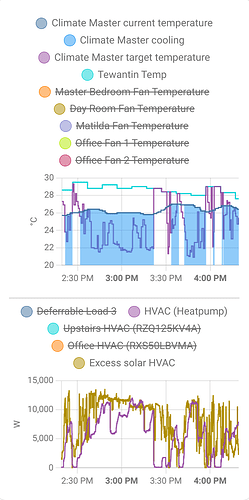

For a day with clouds it looks more like this:
Zooming in for some more detail:
At 16:02 you can see Grid demand (green curve) goes up well beyond the demand limit (as a cloud rolled in and Solar production dropped). A few minutes later the grid demand is back down, as the automation turned off cooling.
So, on sunny days the automation is more effective. On cloudy days, the automation prevents large demand charges from my utility.
