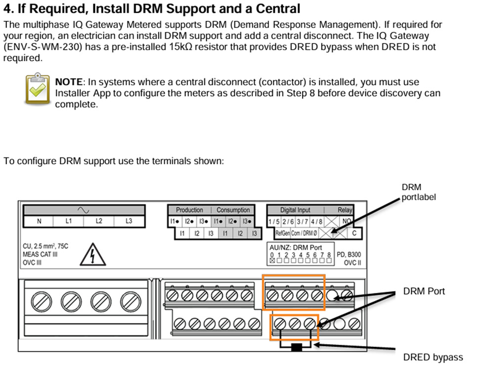

I was looking in to this and how I can stop production via Home Assistant. I found that it is possible using the DRM function on the Envoy S. Im going to try this method and use a Tuya rail mounted switch to close and open the circuit via HA.
CLOSE = Production
OPEN = No Production

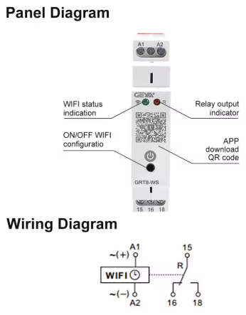

Here is the Tuya wifi relay that I’m waiting to arrive so that i can automate the production control in HA: AliExpress:
25,52€ | GEYA Tuya Smart Wifi Time-Control Relay Switch Wireless Remote 16A AC/DC110-240V for Smart Home Wireless Control Switch
https://a.aliexpress.com/_EuIaZGK
I will be using relay terminals 15 & 18 (NO) connected to the DRM 1 & 3 while leaving the resistor in place. That should mean that the Envoy-S is producing power when the relay is open and when closed it should stop production.
Hi Chris,
With DRM 1 & 3 do you mean the resistor connections?
If yes, this means you are going to short the resistor (switch parallel to the resistor). In the schematic you posted last month, the switch was in series with the resistor. Do you know the difference in the Enphase DRM0 functionality between short and open?
