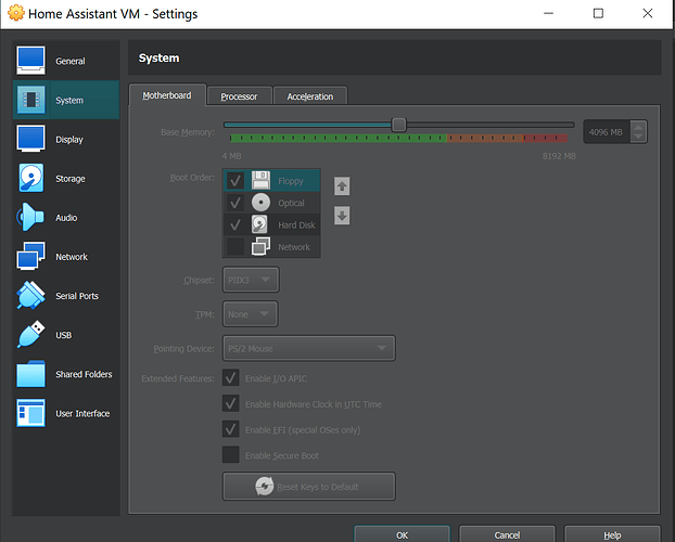

Change chipset to ich9
Where would I find the settings to change the chipset emulation?
NM. I shut down the HA VM and was able to change it. HA is rebooting now. I’ll report back findings going forward.
I’ve been doing a lot of restarts as I set things up but in between restarts, it seems to not be crashing. I’ll keep monitoring of course but thanks for the tip on the chipset!
