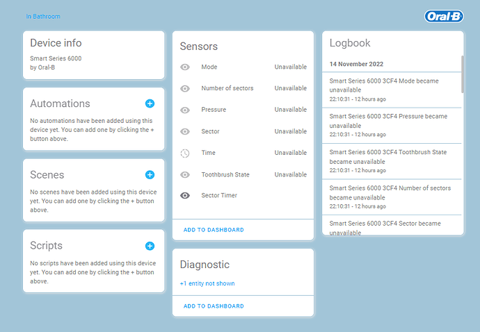

But I noticed the following things:
It’s identified as IO Series 7/8
Tongue Cleaning shows up as “unknown mode 6”
Pressure & Sector sensors have values even though the brush is inactive, maybe default to unknown while not brushing?
How can I help you to gather the data needed to correctly identify the series 10 brush?
WallyR
(Wally)
November 3, 2022, 9:23am
16
It seems the toothbrush only transmitting the values when you turn it off, so these values are just the ones from the last session.
There is no transmission during the brush session.
kevjs1982
(Kevjs1982)
November 15, 2022, 10:36am
17
Interestingly with the “proper” integration my 7000 shows up as a 6000 Series and doesn’t report battery level, but it has picked up a neighbour’s toothbrush which it identifies as a 7000!
Will stick with ESP Home for now - much more useful set of information
vs Home Assistant directly
