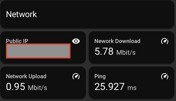

Hi/Bonjour @vikland. Here is what my HA Lovelace Frontend looks like;
The lovelace card is as follows;

BTW - I’m sure you are also aware that the Orange Box is not accurate with its true Up/Download metrics. The attached output uses Speed Test.
