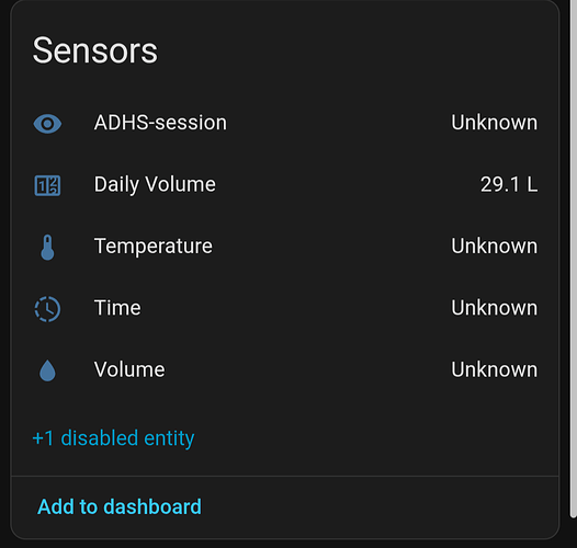

I recently got a Hansa digital shower head and it is working with the IOS app ok.
I downloaded this integration from HACS to try and read the shower head bluetooth output in Home Assistant: GitHub - chkuendig/hass-amphiro-ble: 🚿 Amphiro Digital Hand Shower component for Home Assistant
I have bluetooth enabled in Home Assistant. I am running HA in a Proxmox VM and bluetooth is passed through ok.
From reading github page and a few forum posts on the subject, it sounds like the shower head should autmoatically get picked up by the integration when it is running.
In my home assistant I have a Device called ā€œAmphiro Digital Hand Shower BLEā€ but no entities, and there isnt anything in Integrations.
The Device has nothing in there other than ā€˜Update’ in Configuration and that just displays a spinning circle like its waiting for something. I hoped that would change with the shower running, but it does not.
I had to pair the shower head with the app using a code displayed on the shower head screen, but i cant see any way of doing that in HA.
Im new to Home Assistant and im probably doing something stupid, but i cant get this integration to do anything. Can anyone advise please?

I have one of those and it’s detected by the Theengs Gateway Addon
These are the sensors, they show unknown when the shower is off. The daily volume is a utility meter I set up
