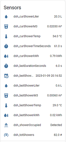

The output:

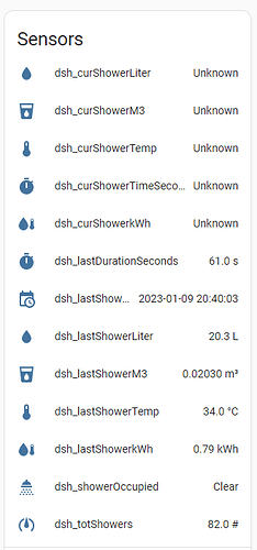

If it has been detected, that the shower head is “online”, someone is most likely using it, and data is being grabbed as often as the shower head notifies about updates
Once 3 minutes has passed since last packet with same “shower count number” was received, the “current” data is moved to “last”, and the “current” are set to unknown.
This gives the possibility to track water/energy consumption, but also an option to see if someone is actually using the shower.
