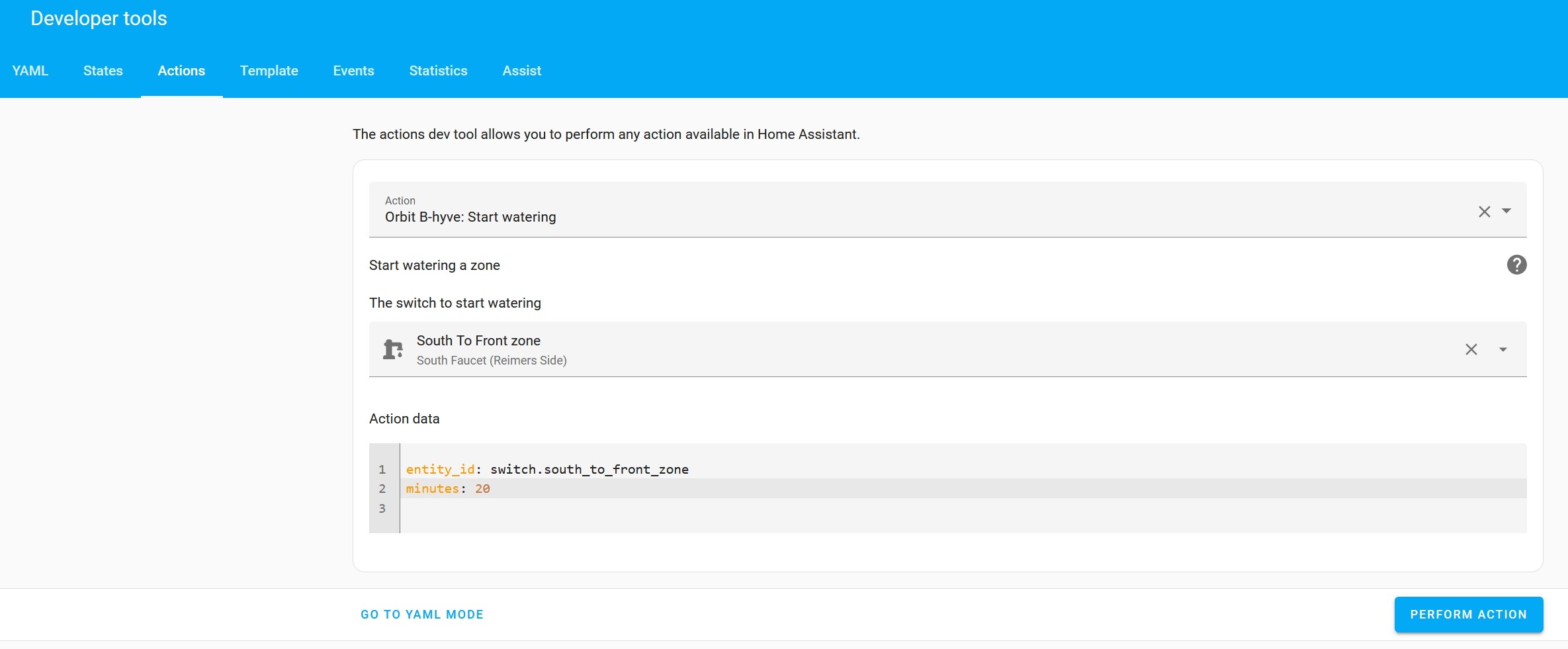

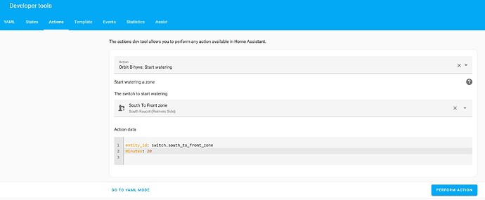

I use the “start watering” service and add a line for “minutes”.
Here is a basic example (in yaml) of the service (for mine) showing how you can enter a set number of minutes:
action: bhyve.start_watering
  entity_id: switch.south_to_front_zone
  minutes: 20
And, here’s a screenshot of mine in UI mode:

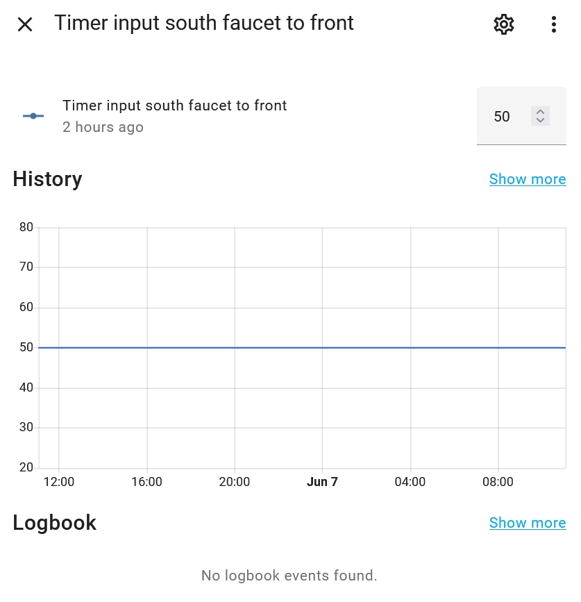

FIRST: Create an Input Helper for the set time: Once you confirm the start watering service is working for you (above), then you can create an input helper for the runtime and insert it’s state for the minutes.
My HELPER looks like this:

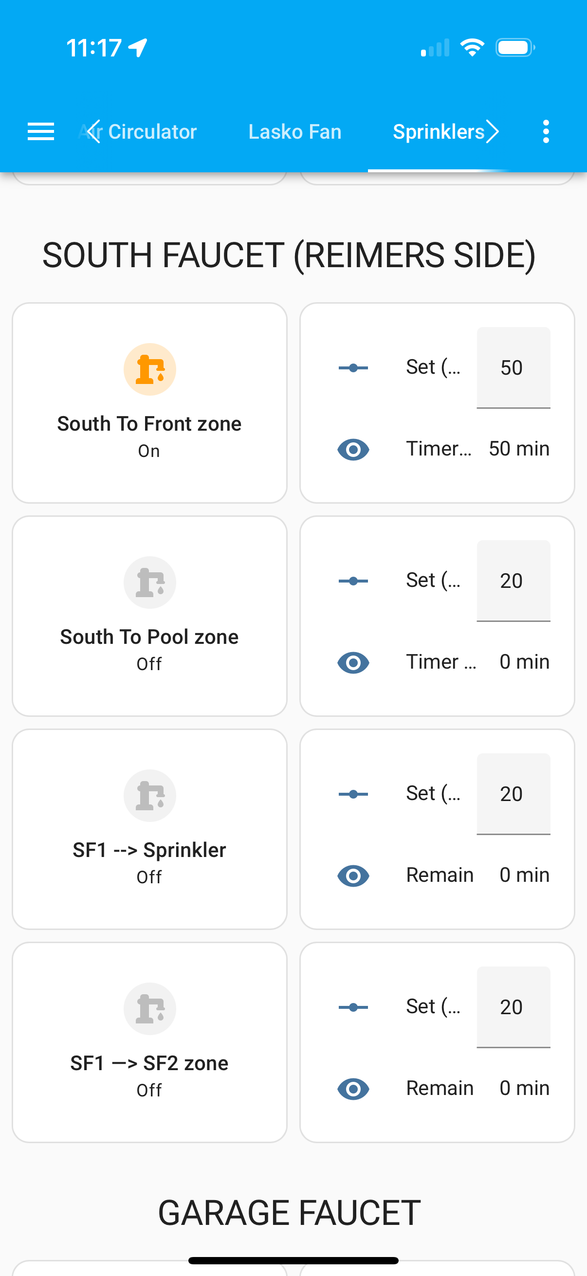

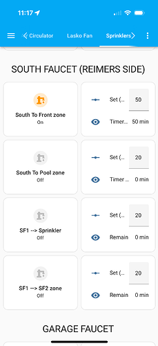

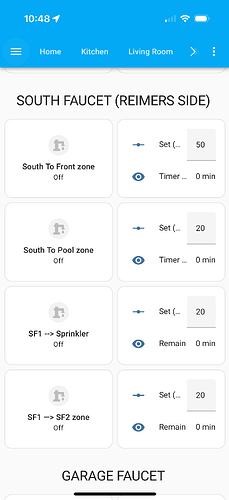

In the end this is what my HA card looks like with all my sprinklers / zones:
When I tap the icon for the switch (left column), then whatever number I have in the input box (right column) will set the sprinkler time and the timer remaining entity (below the input box in the right column) will show you how much time is remaining.
This is what it looks like when enter 50 minutes into the input box and then toggle the switch to on (as time passes, the timer remaining entity will count down - 50 → 49 → 48, etc):
