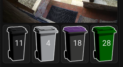

Hi, I’m looking for a way to order these bins (which show the number of days till collection and hence me going to put each one out in time - I missed the monthly green bin today!) so that the most imminent is on the left, that is ordered left to right by days to collection.
Any ideas?
I’ve had a look at various related posts here to see how to do that with “auto-entities” and grid but unable to get it work.
I’m using “grid” for the formatting, “conditional” for if the bins are within a fixed time window (was thinking 2 weeks, but put in 31 days to see all the bins for troubleshooting purposes) and “picture-elements”.
This is the code that produces the part of the dashboard in the screenshot.

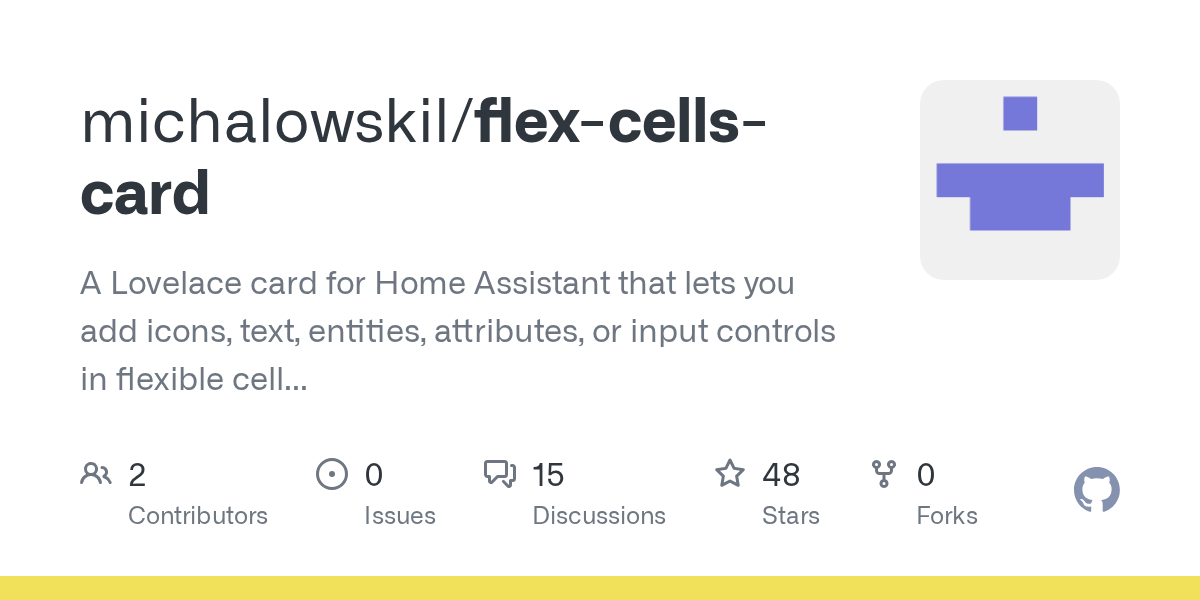

The Flex Cells Card has column sorting capability:

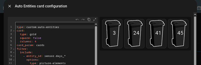

I tried this @Ildar_Gabdullin but couldn’t get it working, because I don’t understand how to do it with different meta data (entity, state, image)
The simplest as a starting point:
type: custom:auto-entities
card:
  type: grid
  square: false
  columns: 4
card_param: cards
filter:
  include:
    - entity_id: input_number.test_level_*
      options:
        type: picture-elements
        elements:
          - type: state-label
            style:
              left: 50%
              top: 50%
            entity: this.entity_id
        image: /local/images/test/lightgreen.jpg
Just use your pattern for entities.
(+ sorting can be added if needed - check the “sort” option in Docs for auto-entities)
But since you need entity-dependent image - that example will not satisfy all you requirements, so will you have to learn more advanced stuff - the “template” option of auto-entities.
But 1st learn THIS simple example. Otherwise, if I provide the ready code for the more advanced case, you will not learn.
P.s. Do not bother about that
        media_content_id: media-source://image_upload/daf1a0495a7fa3c6c979750b4f9fc99c
        media_content_type: image/png
        ... etc
lines, they are not needed for you, just play with “image: some.jpg” case.
P.S. Note that since I got 6 entities for the specified “input_number.test_level_*” pattern, there are 6 cells in the grid. In your case you need to provide a pattern for 4 entities.

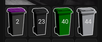

Thanks for taking the time to help. After a few hours of trial and error, I finally managed it by customising the 4 waste bin entities by adding an individual image URL to each as an attribute, sorting a list and looping it in a template…
In my customize.yaml
# IMAGES
sensor.days_domestic_waste:
  entity_picture: /local/media/domestic-waste-bin-small.png
sensor.days_recycling:
  entity_picture: /local/media/mixed-recycling-bin-small.png
sensor.days_paper_waste:
  entity_picture: /local/media/paper-and-card-bin-small.png
sensor.days_green_waste:
  entity_picture: /local/media/green-waste-bin-small.png
In the card
card:
  type: grid
  square: false
  columns: 4
card_param: cards
filter:
  template: >
    {% for state in states.sensor | selectattr('entity_id', 'search', 'days_') |
    sort(attribute='state') -%}
          'type': 'picture-elements',
          'image': state.attributes.entity_picture,
          'elements': [
              'type': 'state-label',
              'entity': state.entity_id,
              'style': {'top': '40%', 'left': '45%', 'transform': 'scale(2.3, 2.3)'}
    {%- endfor %}
