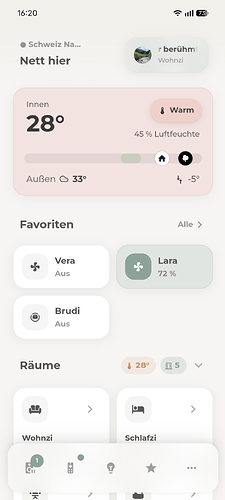

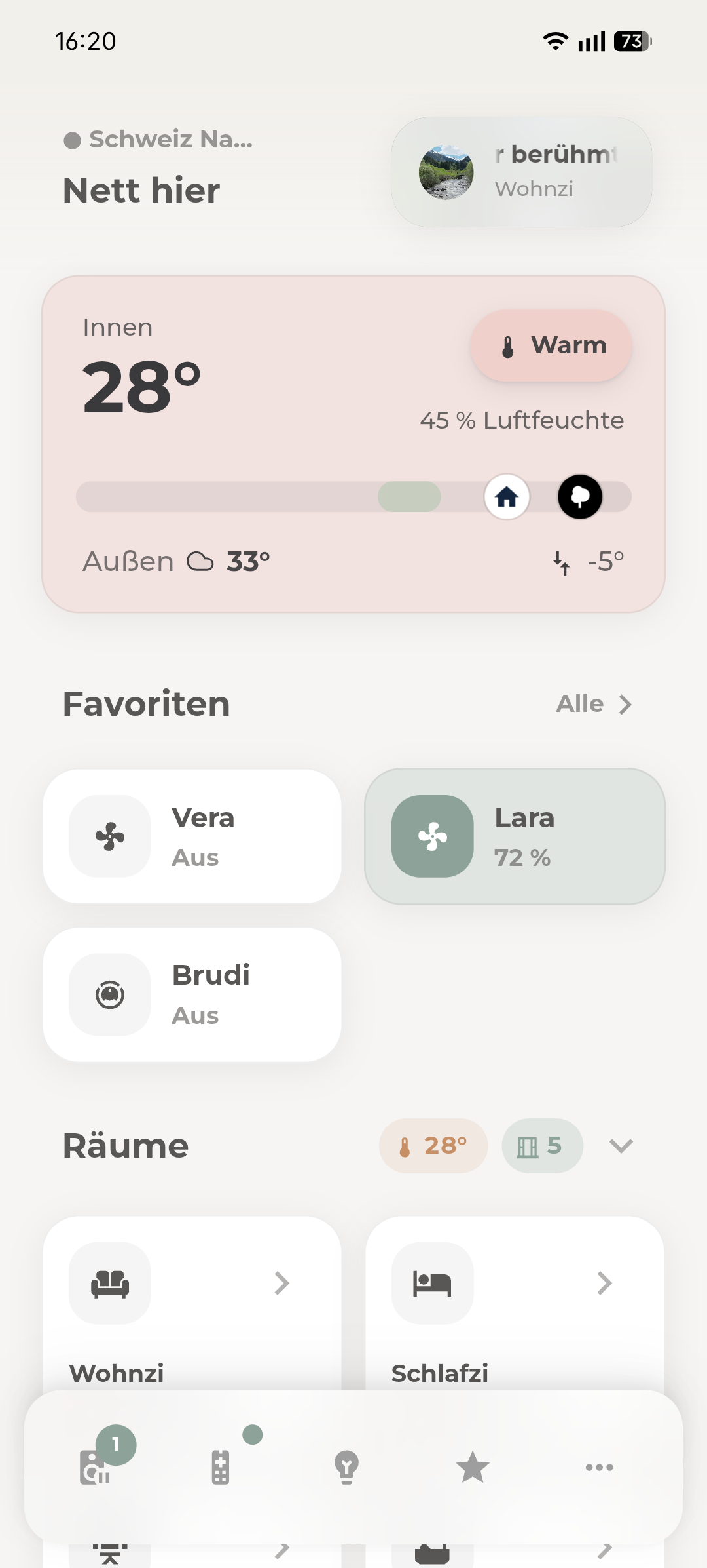

I haven’t seen a dashboard built mostly with paper-buttons-row before, so I decided to document and share my setup. Maybe it’s useful for others. It got created over the last 5 or 6 years and is the result of endlessly changing and improving things.

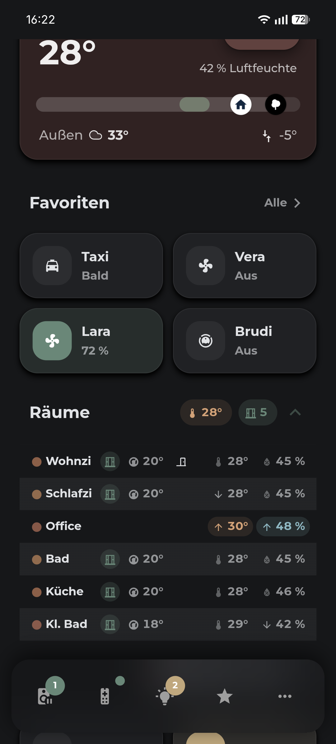

The style of the theme (there’s a seperate theme file) is clean and calm and it supports dark/light mode. The UI tries to be simple and content shows up dynamically, so it doesn’t feel overwhelming. I don’t like content visibly loading, so there’s a big focus on avoiding that.
So far the main dashboard and theme is documented. things like vacuum, music, weather, server, rooms, tv cards/popups and more will follow.
Warning: The whole dashboard is meant as inspiration. It is not beginner friendly.
