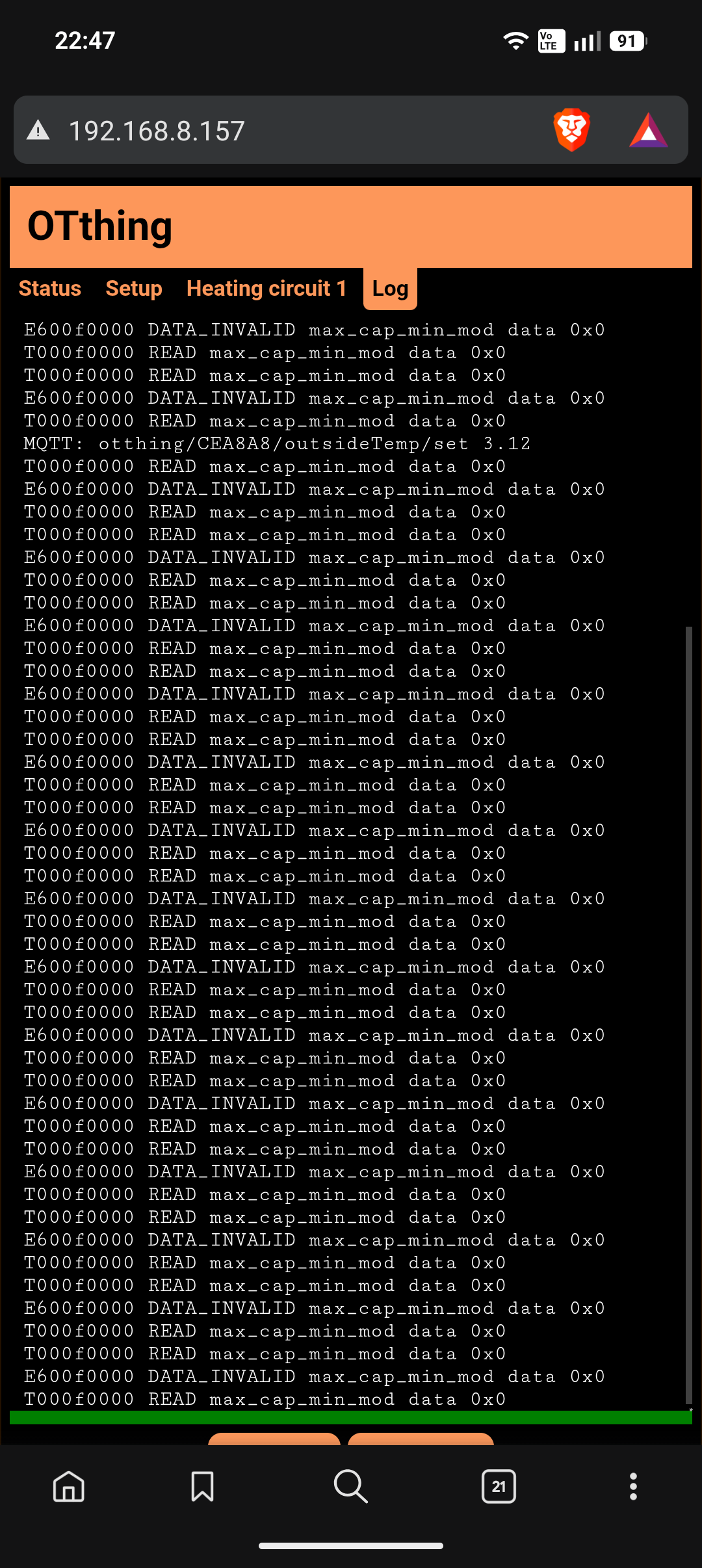

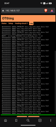

Please find below the 3 json files. I Reseted the otthing unit and this improved a lot. Did not do this prior. Now still switching the boiler is still not working. Hopefully the files gives you some answers. Thank you so much for your reply
Config json
OTitems json
Status json
While waiting for access; when you set the topic …chMode1/set, can you see something (MQTT) on the log page?
Please also provide the log; go to the log tab, let run for some minutes and hit save log button.
Yess you see the MQTT messages in the log
Otthing log
Thank you for the log! We are getting closer! Please hit save button so that OTthing reinits OT communication and again wait a view minutes and send this log again. Thank you for your effort!
Log 2
