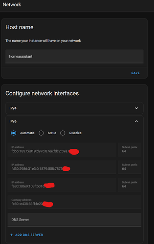

When you say multi homed, do you mean not to run skyconnect with multiprotocol? No that shouldn’t be in use if I understood correctly that needs to be enabled manually somehow.

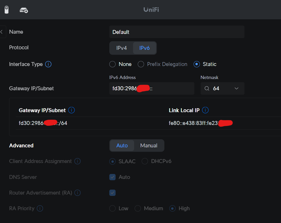

Ipv6, I see it is enabled in HA but not in my router? Is that the problem? Even if I want to add a Thread product? I thought Thread was it’s own separate network. I will add this a bit later today. Thanks!
Multihomed means running it with multiple network interfaces connected.
Thanks for the input and clarifications WallyR!
I don’t have multihomed network setup. I have been planning it but it’s still in the backlog. All devices on the same network and SSID.

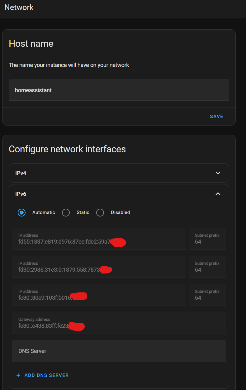

I checked the network settings in HA and there IPv6 is already enabled:
IPv6 however wasn’t enabled in my Unifi Router so I added it there by the help of this thread but by the comment I also learned that maybe it wouldn’t be needed since it is only needed for HA. But I added it either way:
But it still doesn’t work and I have the same error in the logs. If I understand this correctly my HA and router now has two different IPv6 setups? Do I need to make my HA use this setup from the router? Should I add the router as the DNS server, and what address is that then, is it the Gateway IP shown in the screenshot or is it the Link Local IP? Haven’t used IPv6. For my HA IPv4 setup my router is the gateway and DNS server.

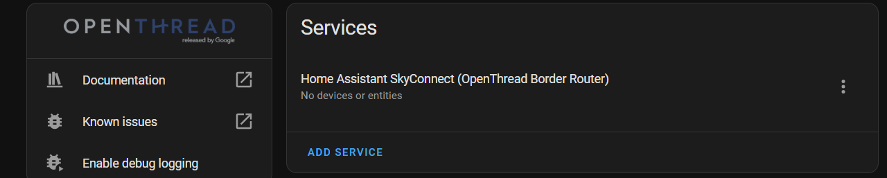

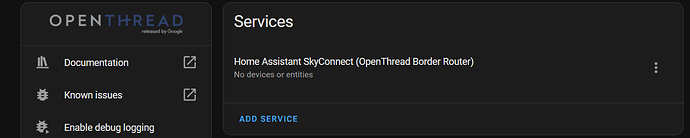

Hey WallyR, did you have any other recommendations or ideas what the error message could mean or how to solve it? Thanks! :slight_smile:
If anybody finds this thread. I got a new device and this one properly commissioned. I still have the error as mentioned in the logs above but it doesn’t appear to actually cause any problems.
