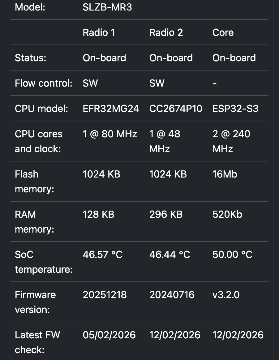

Honestly I’m not too sure where to start with this one. Any help or suggestion would be great. Download firmware?? Thanks for any suggestions
Did try downgrading slzb-mr3 firmware SLZBOS 3.2.4->3.2.0 however that didn’t make a difference either.
Exactly the same opportunity.
Restore in combination with downgrade to SLZB-OS 3.2.0 does not work.

After reverting from 3.2.4 to 3.2.0 and then upgrade to 3.2.4 again and a physical power off, wait 30 seconds and a power on of the SLZB-MR3 it started working again.
Strange but it is what it is.
I was pretty happy with the SLZB-MR3 but going from 3.1.3 to 3.2.0 a while ago and going from 3.2.0 to 3.2.4 today was challenging.
Hey I should probably mark this thread as solved however i took advice from this reddit thread: https://www.reddit.com/r/homeassistant/comments/1qkt6m7/slzbos_v320_update_went_through_without_issues/#:~:text=Updated%20earlier%20this%20morning%20and,Zigbee%20side%20is%20working%20fine.&text=Had%20the%20same%20issues.,Good%20luck.&text=Had%20the%20same%20issue%2C%20reinstalling,radio%20solved%20the%20issue%2C%20thanks!&text=Awesome.,I%20get%20home%20this%20evening.&text=Also%20it%20works%20for%201,you%20on%20the%20long%20run?
Bottom line is I needed to reflash the thread radio firmware – no indication I needed to do this – no errors – and just reflashed to same version. I’m using MR3 and have the thread radio on the EFR32MG24 chipset. Reflashed with 20251218 firmware version. Restarted OTBR add-on (or app), and everything just came up. I didn’t physically try to unplug the POE power from the device so I can’t vouch for your observation.
I did exactly this, and mine also started working again.
I had the same issue today going from 3.2.7 to 3.2.8, downgraded back to 3.2.0, did not help, upgraded back to 3.2.8 did not help, did a 40 sec power cycle on the POE and it went back up again.
So power cycle your unit before you downgrade/upgrade
+1 for power cycling the POE on my SLZB-06P7, OTBR was borked after updates tonight. After looking at the logs i had the same message about migration python failing. I could also see no connection to the socket on the device for the radio connection via the SLZB logs.
