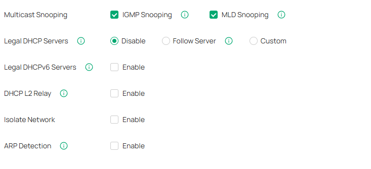

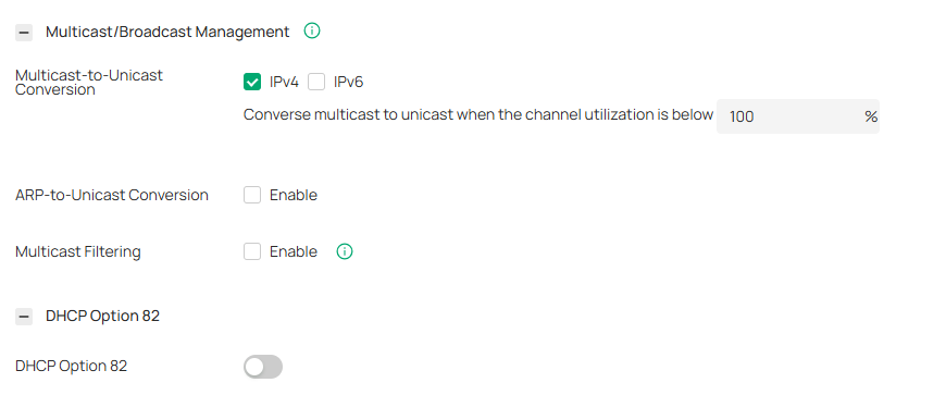

  • IPV6 enabled on tplink Omada with local DHCP v6 and local range fe80

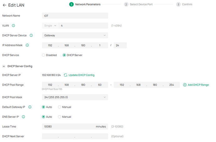

  • multiple vlans. HA and iot clients are in vlan4. Usage of WIFI SSID with same VLAN ID

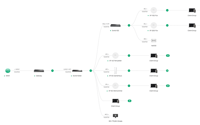

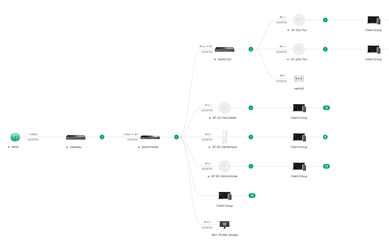

Network overview:

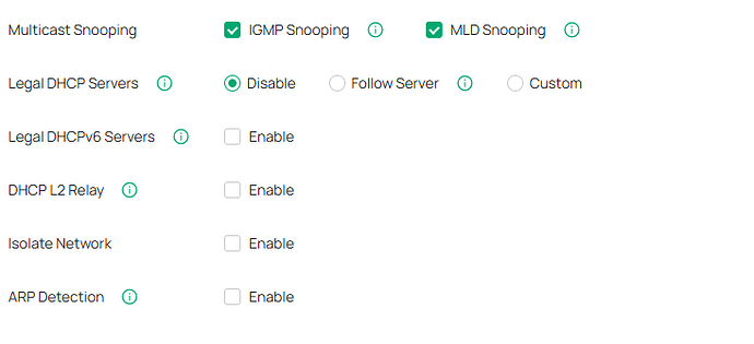

Network settings for VLAN 4 (iot):

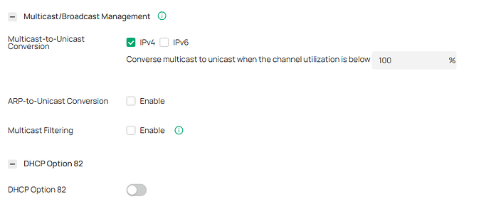

WIFI settings:
  • WPA2 PSK
  • vlan id 4
Omada Internet settings:

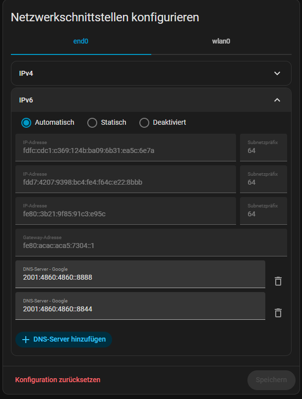

HAOS Network:
HAOS OTBR settings:
does someone has experience with a tplink Omada setup.
I could imaging that I may need a static route ore a setting not available in controller mode.
Do I need a ULA address, it seems not to be supported by Omada
Thanks in advance for any hints and help :slight_smile:
