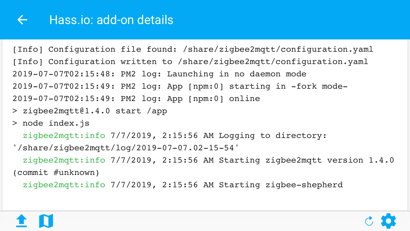

I recently install Zigbee2mqtt addon with cc2530 coordinator on a Rpi3 with Hassio. When I started the addon I only see the log stop at this point…

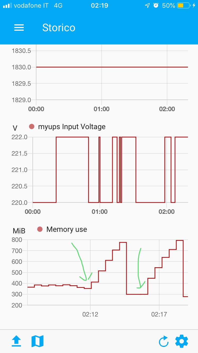

Then in a couple of minutes the whole system slow down because of memory consumption until everything stop.
As you can see in the graph below when I start the addon the memory consumption goes up…
How can I solve this problem?

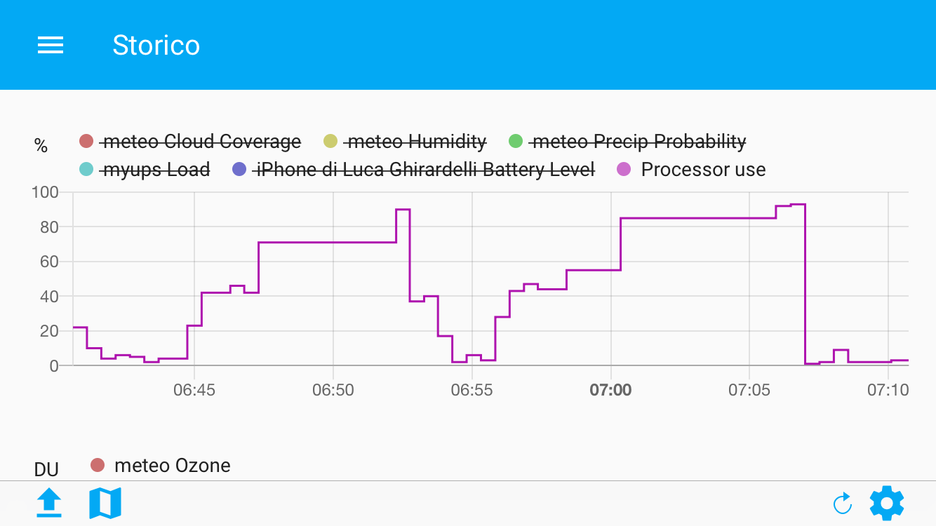

How about cpu usage?
