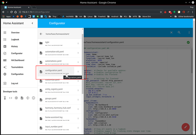

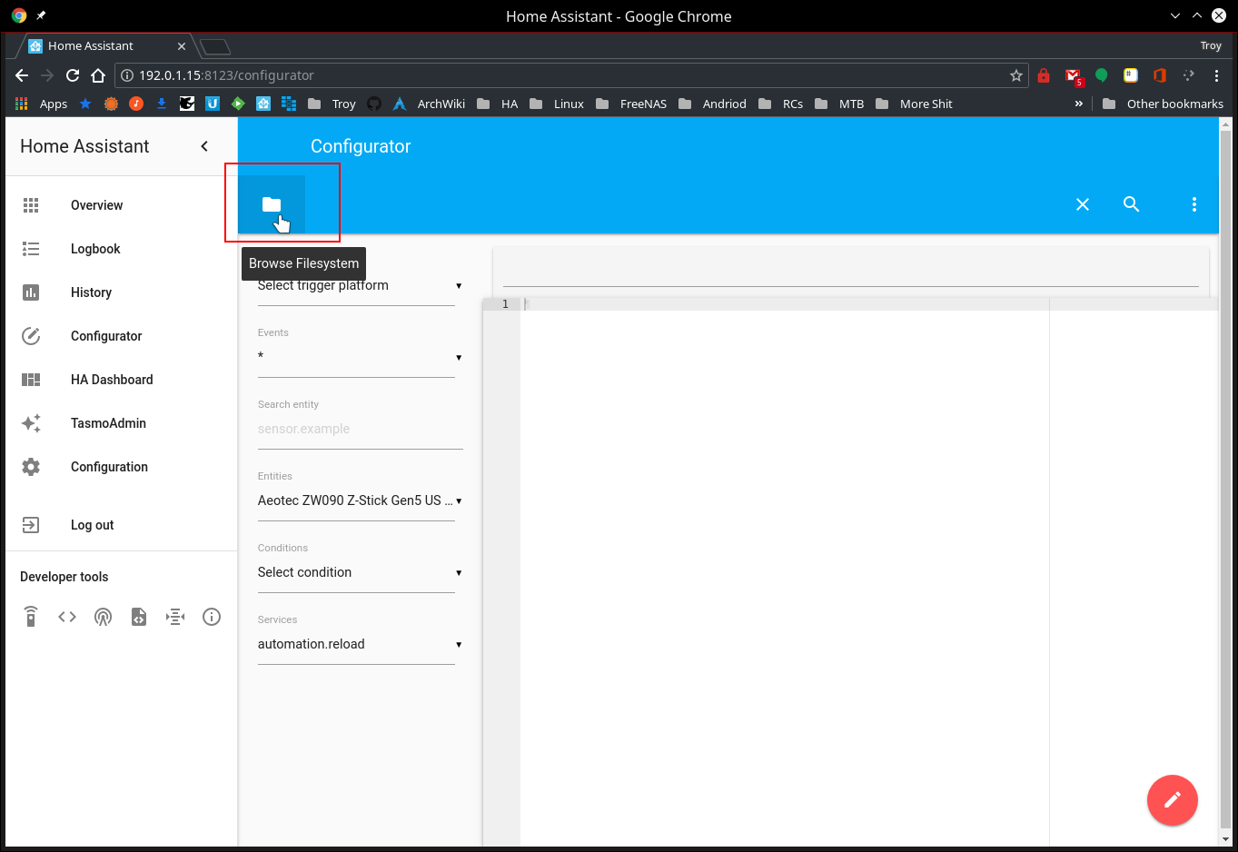

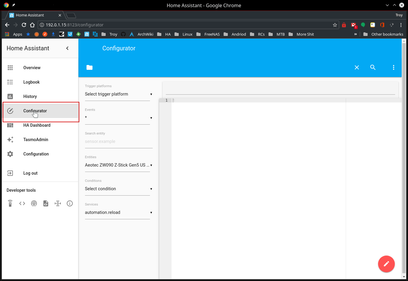

How do i go about accessing the yaml file ?
You can use the Configurator to edit the yaml files. Sorry I don’t have time to better explain but hopefully a pictures can help.
