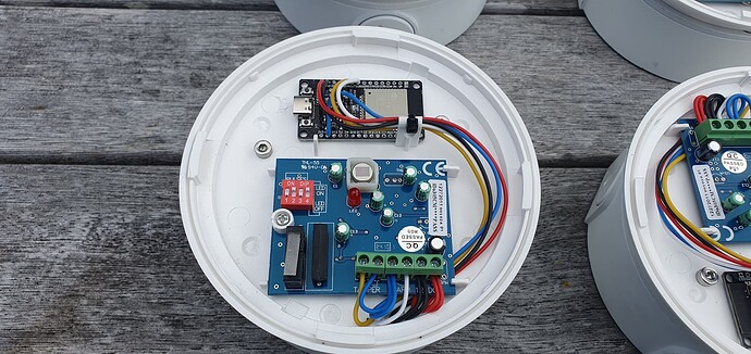

So, i’ve got my PIRs almost down, but one is giving me greif with false positives. Its in a relatively harse enviroment with sun in the morning, but i’m also getting false positives at night. It’s a pretty cheap outdoor 12v PIR ive converted with a ESP32.
So, i’m considering getting something a little more expensive, or even going down the microwave route and ideally something available locally here in NZ.
I dont mind something that I can convert to ESPhome with a ESP32 and a relay etc.

Yeah, well… the fact is that two technologies are very different, so for decent sensing i think combination is a very good solution. You can use, say, any classic PIR sensor and LD2410, together with esp board and esphome you’ll make a great and highly configurable sensor .
Regarding sonoff : i have a few sonoff devices, also some shelly ones, but on all my devices first thing i do is replace original FW with esphome one.
Well, i see that you do have space left in your enclosure, ESP is powerfull enough, so just add LD2410 and you’re done. MW detects through plastic, so it doesn’t really matter where you fix it.
And get BT one, so that you can configure it with phone, since esphome (officially) doesn’t support changing parameters yet.
Or, since i see that you used burglar sensor: get a combo sensor (IR+MW)…
