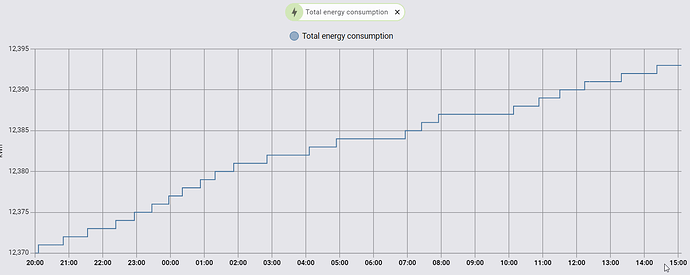

If I look at the original sensor the history graph looks as follow:
The filtered sensor shows the following graph:
There are several decreases of the values while there weren’t any outliers in the original sensor at that moment. I’m trying to understand the outlier filters but I’m a bit stuck here. What am I missing?
those are larger than your radius, increase the size of your radius to something like 100.

This is a bit old thread, but google got me here while trying to solve my own problem with outlier-filter. Still don’t know what is wrong with mine, but i thought to say what i think is wrong here.
Window size of 10 makes this code check last 10 values, all of them should be smaller than the always increasing new value. Median selects the middle one of those values (average of middle two with even number of values), after sorting them. So, that value which is compared to the new one, should be 5.5 smaller than the new value.
Then there is the radius of 5.0. I don’t actually know how that filter even worked as well as it seems in the graphs, maybe some values are read multiple times and that median of last 10 values usually gets closer to the new value and passes that filter. Those dips in the graph might happen when there are exactly one update per kilowatt increased and filter failure chooses the median of last 10 as the new output.
So, smaller window or larger radius should help.
