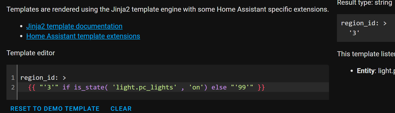

{{ "'3'" if is_state( 'your.entity', 'on') else "'99'" }}

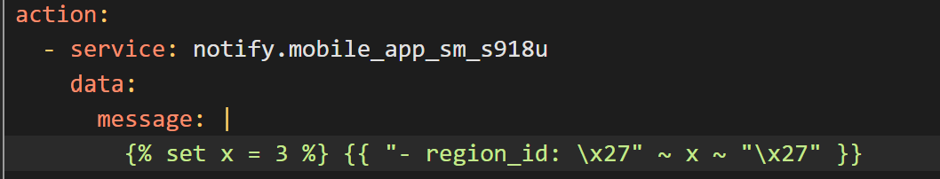

I tried it in a UI-generated script:
alias: quote test
sequence:
  - service: notify.admin
    metadata: {}
      message: |
        {% set x = 3 %} {{ "- region_id: \x27" ~ x ~ "\x27" }}
mode: single
and my phone notification has the quotes.
Hex 27, decimal 39 is the ASCII code point for the single quote.
I tested your code in actual automation and recieved the quotes as well

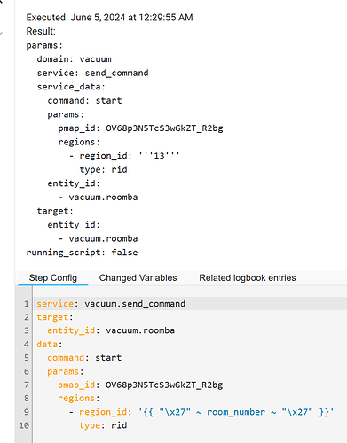

The same result:

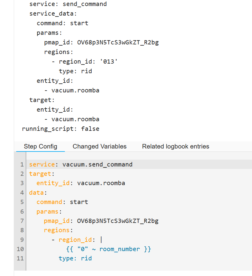

adding the | on the - region_id: | line results in:
  • region_id: β€˜β€™β€˜β€™β€˜13β€™β€˜β€™β€˜β€™

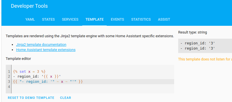

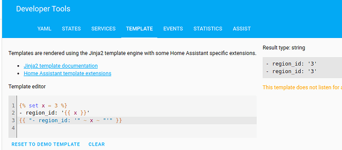

{% set x = 3 %} {{ '- region_id: \x27' ~ x ~ '\x27' }} produce the correct outcome?
Not when I try to use it in a blueprint script, in the template editor it looks all as I would expect.

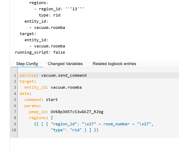

Long shot, defining as JSON rather than YAML:
        regions: >
          {{ [ { "region_id": "\x27" ~ room_number ~ "\x27",
                 "type": "rid" } ] }}
it does insert the extra quotes this way as well

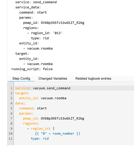

when I add a 0 for the number it seems that the quote is added correctly:
The vacuum works this way. It seems a big hack, if I give the number as a int or string it fails. When a 0 is added before the number, it seems to see that it needs β€˜β€™ to keep it the same
My gut tells me this is the source of the additional quotes
test without the quotes
room_number: {{ states(room).split(',')[1] | int}}
