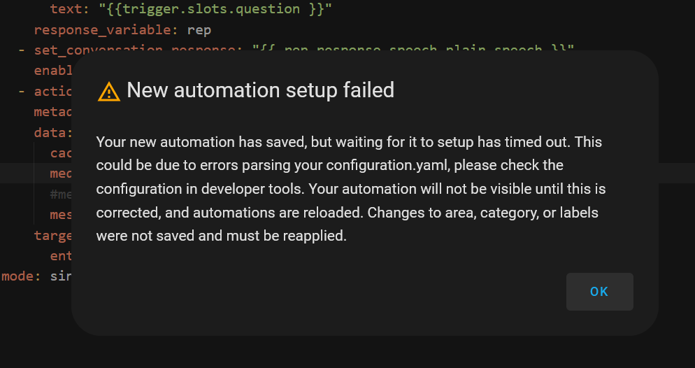

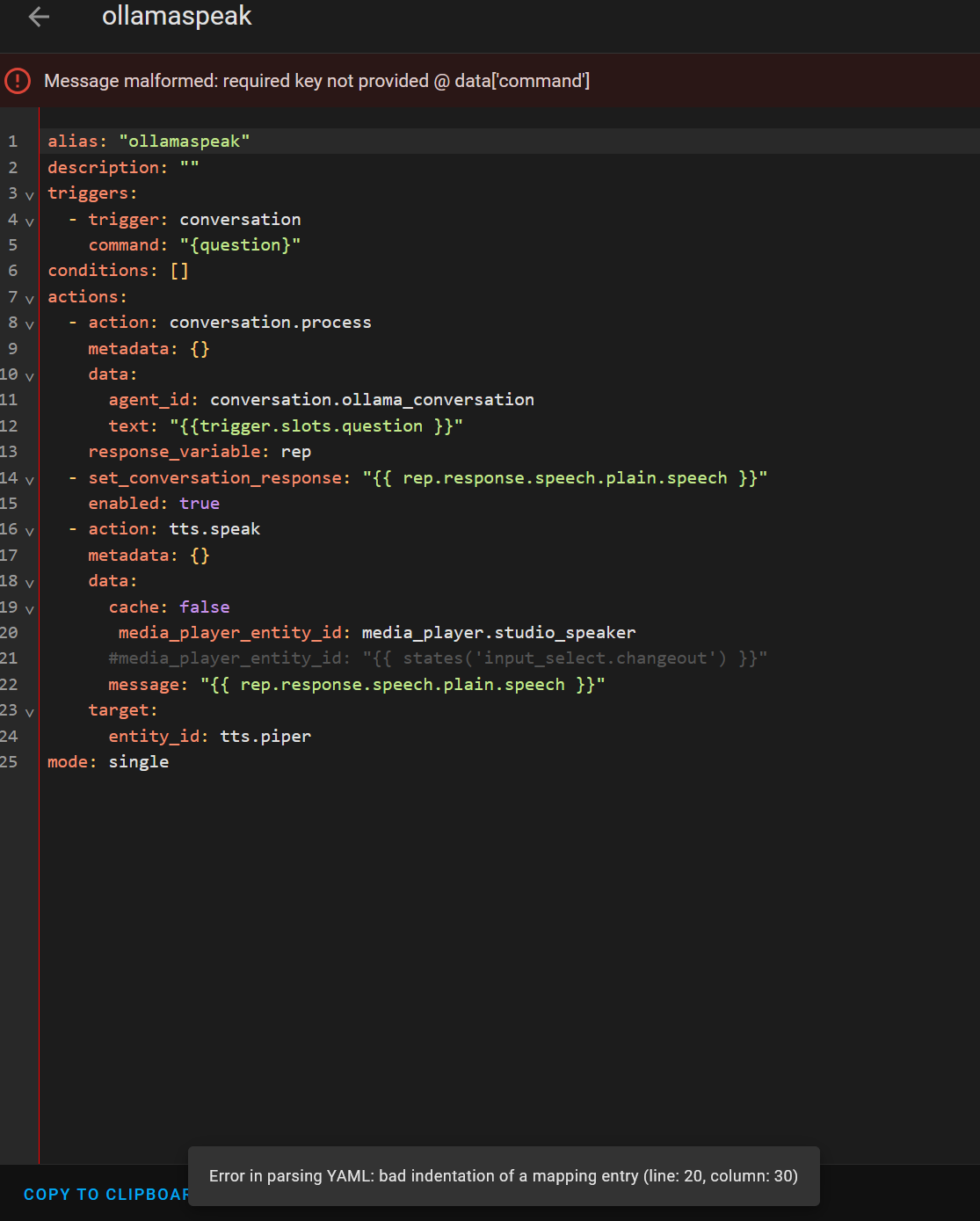

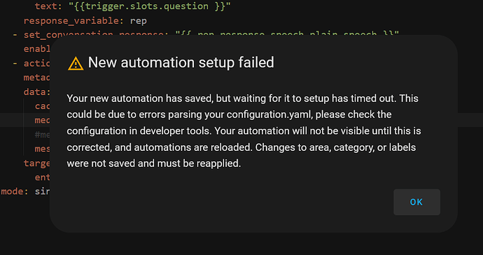

I don’t quite follow your (accepted) answer in the other thread. My Entity is “Studio speaker”. Yaml isn’t saving.
“Message malformed: required key not provided @ data[‘command’]”

Also - It’s not clear to me why we are using an automation. Shouldn’t piping TTS audio from VA to a speaker be in the VA settings?
alias: "ollamaspeak"
description: ""
triggers:
  - trigger: conversation
    command: "{question}"
conditions: []
actions:
  - action: conversation.process
    metadata: {}
      agent_id: conversation.llama3_2  #change this
      text: "{{trigger.slots.question }}"
    response_variable: rep
  - set_conversation_response: "{{ rep.response.speech.plain.speech }}"
    enabled: true
  - action: tts.speak
    metadata: {}
      cache: false
       media_player_entity_id: media_player.studio_speaker
      #media_player_entity_id: "{{ states('input_select.changeout') }}"
      message: "{{ rep.response.speech.plain.speech }}"
      entity_id: tts.piper
mode: single
try this

OK this auto is actually triggering - so we have progress. It just says “Done” on Satellite - and Google speaker works with Piper, but not Elevenlabs.
alias: ollamaspeak
description: ""
triggers:
conditions: []
actions:
    metadata: {}
      agent_id: conversation.ollama_conversation
  - set_conversation_response: Stand by
    enabled: true
  - data:
      cache: false
      message: "\"{{ rep.response.speech.plain.speech }}\""
      media_player_entity_id: media_player.bedroom_speaker
    action: tts.speak
mode: single
Issue in getting studio speaker working was it had gone offline. Tried another speaker and it’s working. Shame that it’s only Piper as that’s the main point is Elevenlabs is not working with Satellite. Only Mobile App and Browser.
