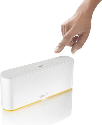

I see that the Tahoma switch is in stock again after a long time.
Are there more people who want to join with me to buy it for @imick so that he can develop it for us?

Iâll donate (free of any obligations) if thereâs a link but I couldnât find one.
Same! Would love to get the local API fully up and running!
Thanks folks. If you want to donate, here our links:
@imick is the most active currently.

Thanks all for your donations. I was able to purchase the Somfy TaHoma Switch and add it to my Home Assistant. No devices yet, but I will have a look at Marktplaats/Ebay for a cheap Somfy Power Plug.
Having a hub will help at least for the development, since I donât have to use VPNâs to remote places anymore, or borrow credentials.
I am thinking about creating a separate topic for this, to split the discussion and testing. There are still some design decisions that have to be taken, since my initial PR does not support all scenarios.
