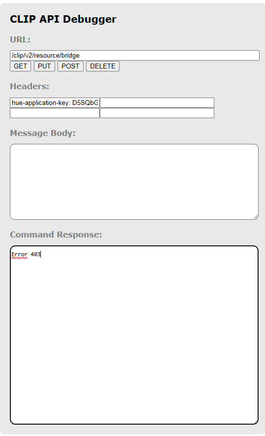

And i can’t pass the “Step 4”, i get “Error 403” in the Command Response field
From “Step 3”, i get "username" not “hue-application-key”
Any idea how to fix this?
With this method I also got the same error.
It worked for me using the method described in this Reddit post Link to post
