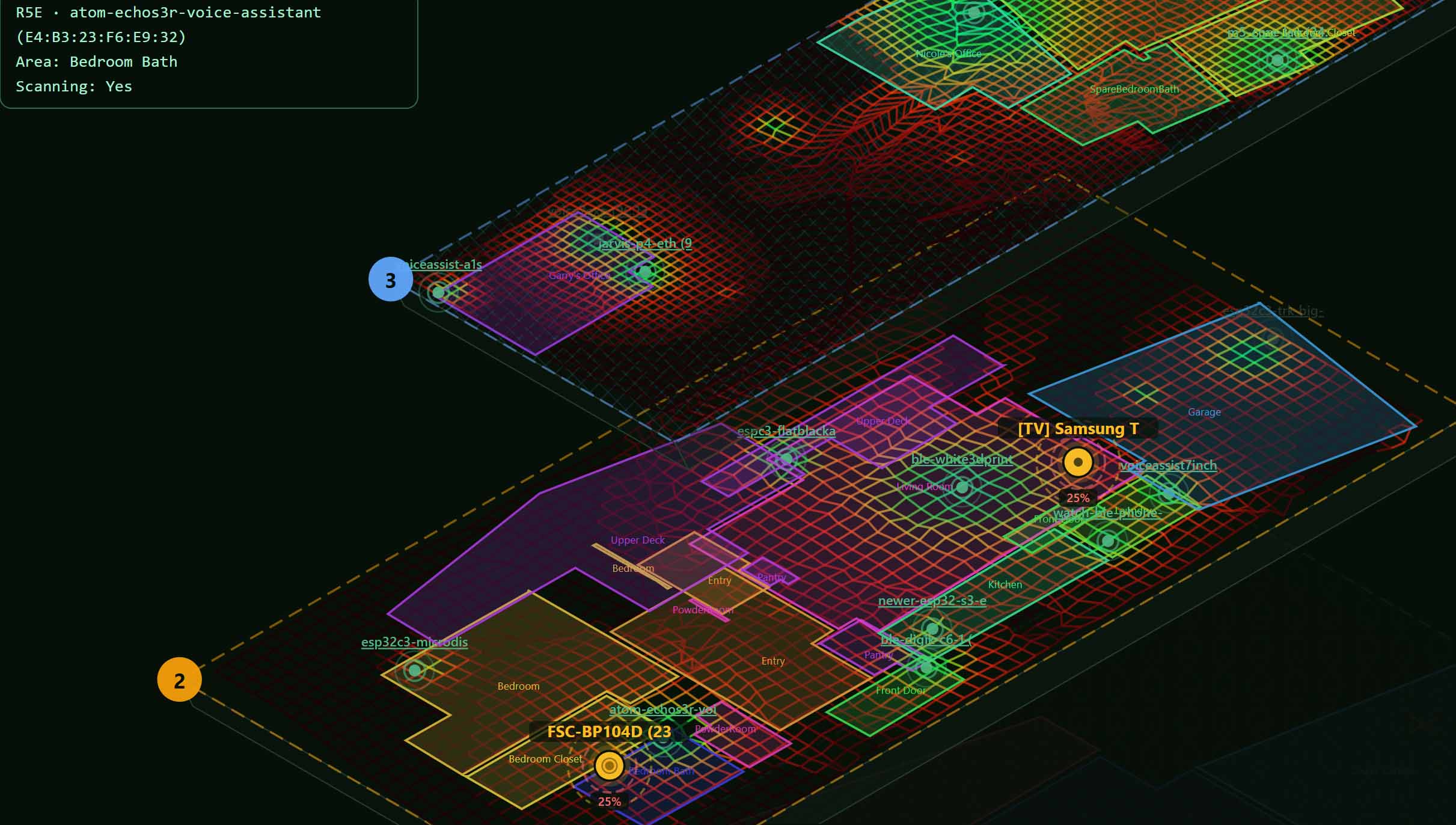

Multi floor actually works now. The floor list never reached the positioning code, so a multi storey house was being scored as a single storey. The panel looked right the whole time because it reads the HA floor registry live, which is exactly why this survived as long as it did. Floors with no level set were also stacking in creation order, so an alphabetical registry could stack a house in the wrong order.
Geometry moved off the picture. Rooms, scanners, walls and lights are stored in metres in their own model now, instead of as coordinates on the floor plan image you uploaded. Re-crop or replace a plan and nothing moves.
Scanners carry a real mounting height and floors carry a real elevation, so a cross floor decision finally has something to separate storeys by. Walls are RF barriers with an attenuation value rather than decoration.
Auto calibration writes fingerprints from stationary beacons, which means less walking around the house with a phone in your hand.
RSSI Vector Capture (Settings > Features, off by default) records what every scanner heard for every tracked device, poll by poll, with a Mark room button to stamp ground truth as you walk. Export the session as jsonl and replay that same walk against different settings instead of walking it again.
