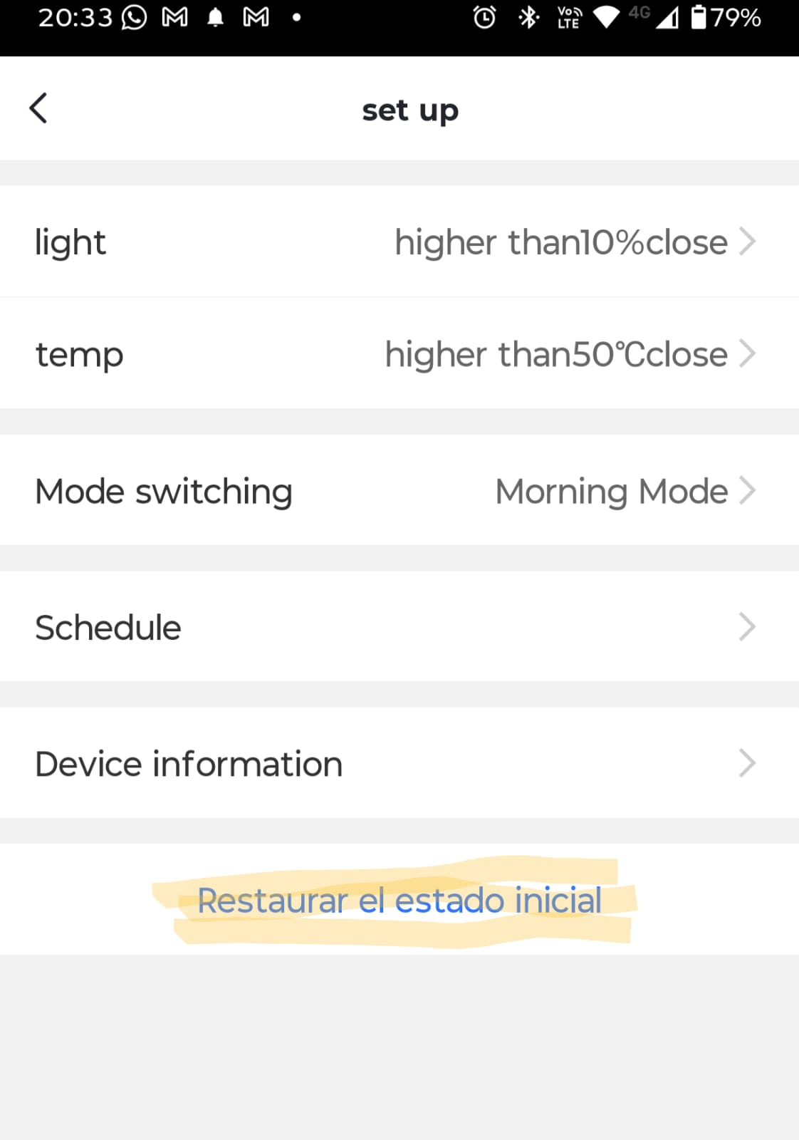

Good results after repeatedly pressing the reset button to get the “fast flashing blue light.”
The next problem was the setup. It looked like I was on the correct setup screen, but nothing happened. The motor didn’t move at all, so it never received the information about the open-distance set point.
What worked:
Tap the gear icon in the upper-right corner and select “Restore to the initial state” (the wording may be slightly different; I’m translating it). After that, go back to the setup screen, and when I pressed Start, the motor finally moved.
You have to press Stop when it reaches the final position.
Once that was successfully set, I continued to the next screen for control (I used the Smart Life app).
