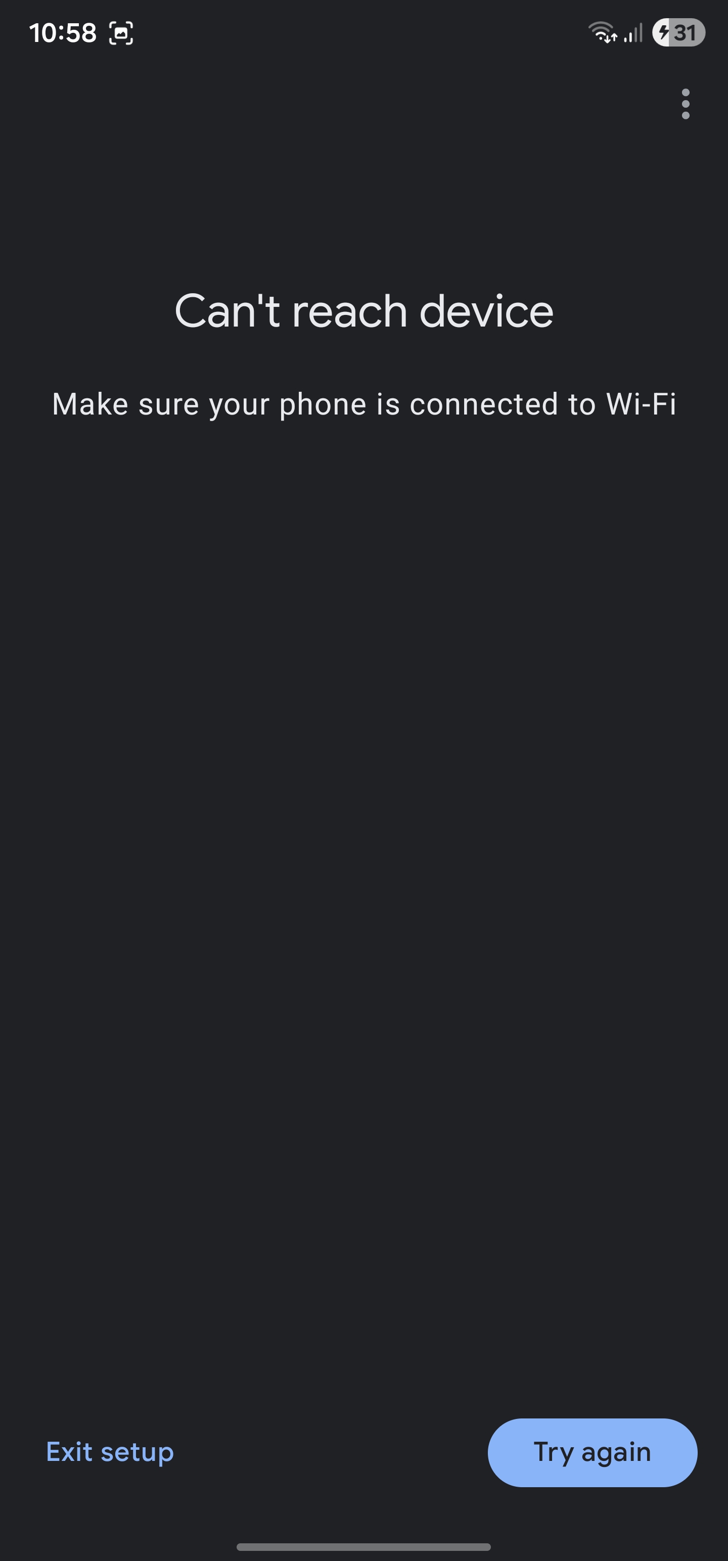

In the same boat with this Grilllats. I’m on latest version of home assistant as of today wtih zbt-2. Last week I was able to pair a battery operated water leak sensor from Ikea without issues. I tried adding 2 of the Grillplats and none of them would pair. I’m trying to pair from the android home assistant app and it keeps going to “Generating credentials” after I reset the device and then hangs at “Checking connectivity to Thread network ha-thread-xxxx” and then eventually “Can’t reach device” Make sure your phone is connected to WiFi. That last part is the silliest of messages given that I am able to reach home assistant server from my phone!

I must have reset this thing (and another one also since I bought 2) about two dozen times each! Looks like my android phone sees the device and sends it the thread info but the device appears to go silent after that based on lack of any logs after that.
Whew, got it going after losing all but maybe one strand of hair remaining on my otherwise lush head.
Turns out I had to enable IPv6 on all of my network interfaces in home assistant. My home assistant is dual homed with one interface facing my router and another facing an internal network. For some reason (still don’t know why this is necessary) I needed to turn on IPV6 (automatic) from the Settings->System->Network page.
Then it magically worked! Hope this helps someone keep their hair.
