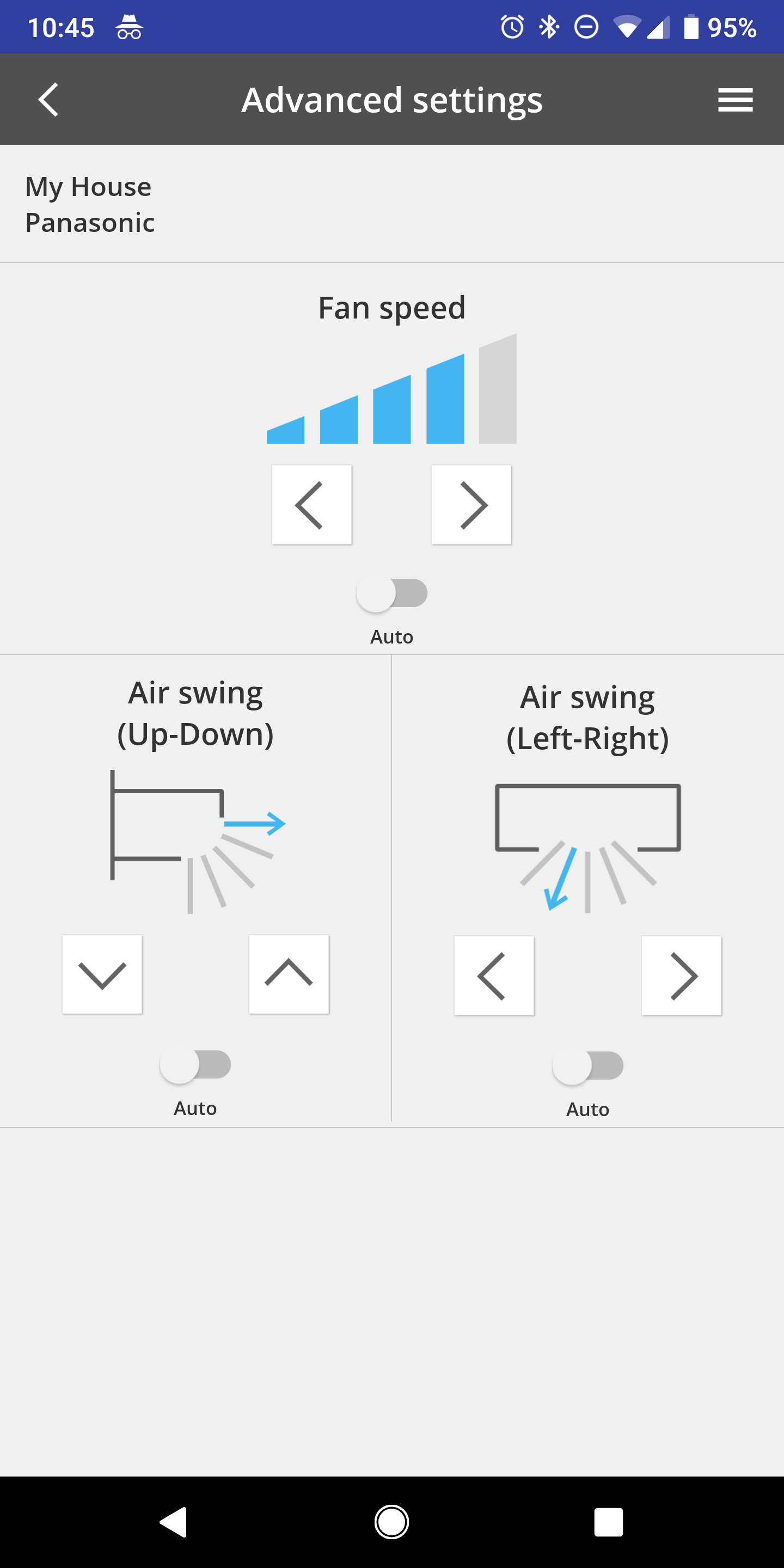

The climate component wouldn’t load into HASS when I had this error. What I did notice was that this was when I had the Airswing (Left-Right) set to this value
Changing it to the middle one - the climate component loads just fine into HASS.
I need the Air swing set to this value because of the location of the pump so a fix would be great. I’ll test your suggestion first.

it didn’t help (unable to load component into HASS)… but
Changing line 371 in session.py in pccomfortcloud (under deps)
value['airSwingHorizontal'] = constants.AirSwingLR(parameters['airSwingLR'])
till
value['airSwingHorizontal'] = constants.AirSwingLR(parameters['airSwingLR'] -1)
Makes the component load without errors when I have this swing mode set.
There’s no actual need for me to be able to change swing mode from HASS - enough with speed and temperature.
