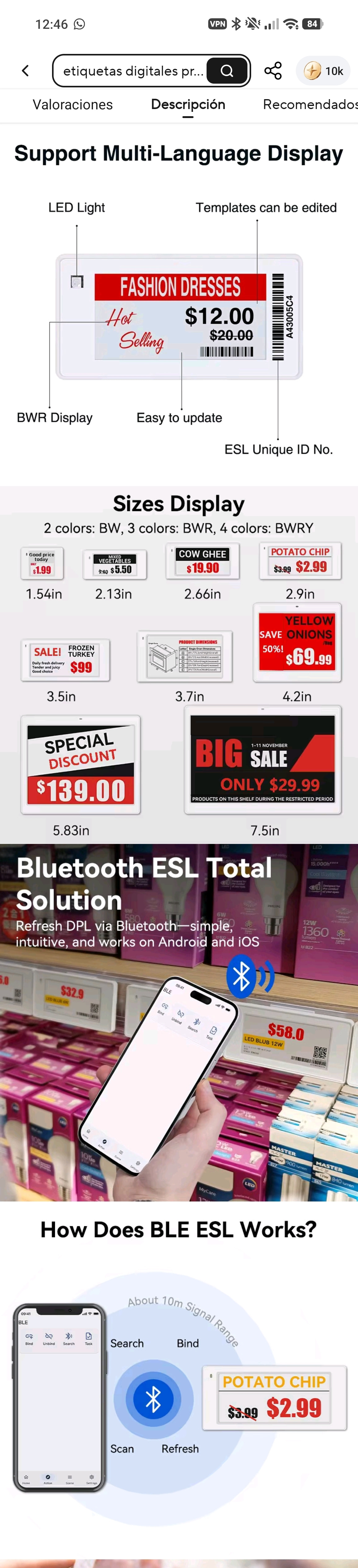

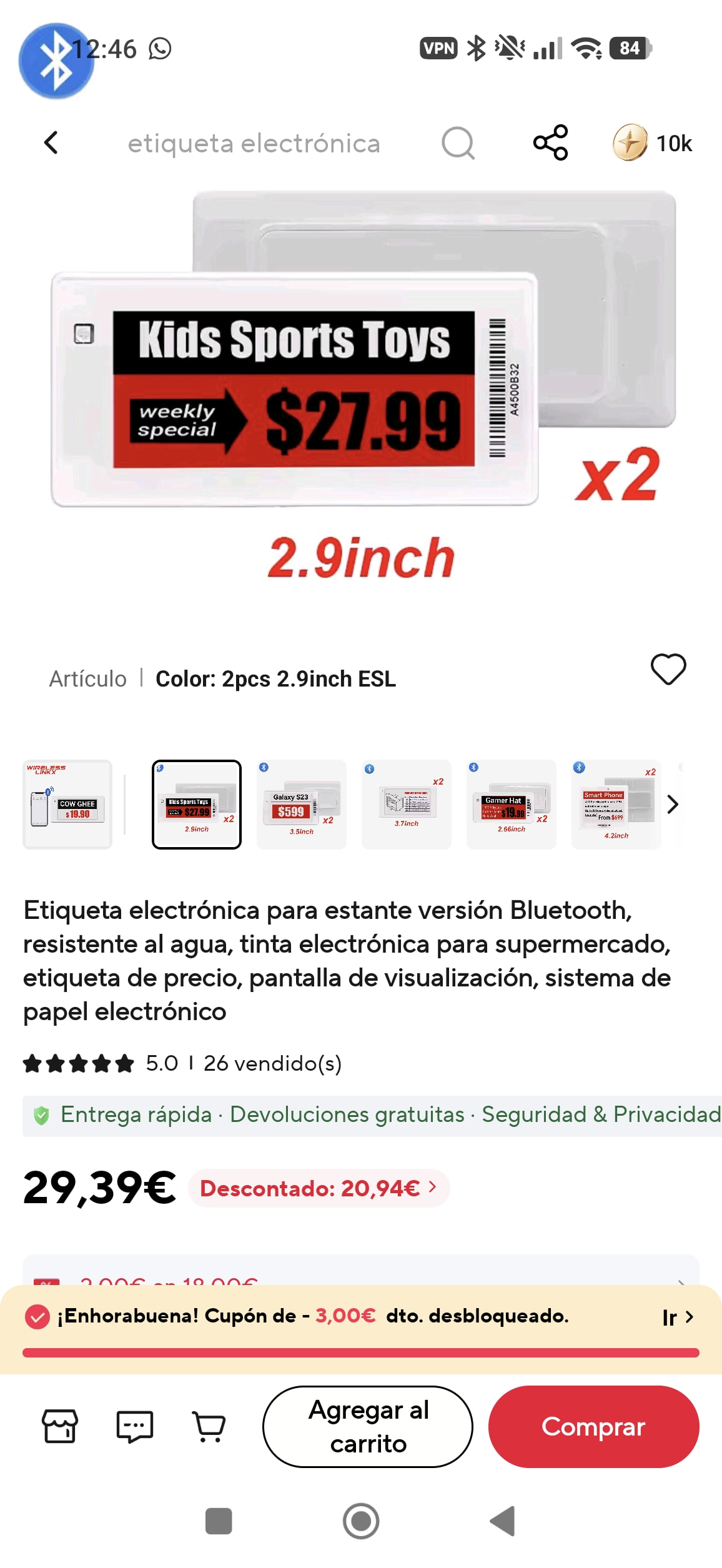

Aliexpress is so annoying… that link doesn’t work for me, maybe send a screenshot?
Can you see who the seller is? This looks exactly like the products I have but I’m not 100% sure. If you can tell me who the seller is, I can verify with the company
Wirelesslinkx Store
I asked them, they say it’s not their products. It does look exactly like it though, so if you’re feeling adventures, willing to take a risk, and are a little computer savvy, then you can order and when it arrives I can see if we can reverse engineer it together and add support, but I cannot guarantee it. I’m still waiting for them to get their store finalized, they said it’s coming.

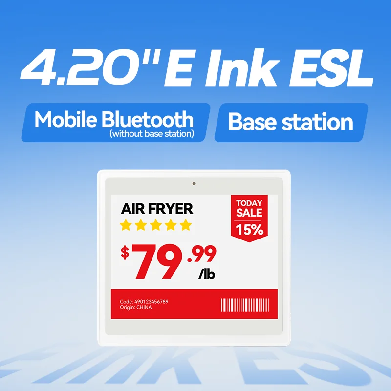

I ended up buying this model.
The store is: JSJ ESL Electronic Shelf Label Store
The 4.20-inch model is very well priced, and the communication protocol is Bluetooth.
Once it arrives, I’ll let you know if I can get it working with your integration.
