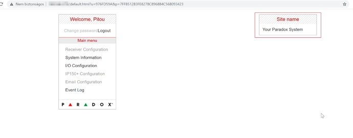

Btw, I seen this before, I was wrong, there is an error actually on my Paradox MQTT adapter:
It looks like it’s expecting a different page after logging in “Your Paradox System” is indeed a text you can read in the below screenshot. This is the page the non system user see, the one that is configured:
and btw, unfortuantely my firmware versions are v5+, I don’t know if this is causing it or not:
Yep, you are using the wrong addon (stated clearly in the docs). There are other ones for v5 firmware and up.
