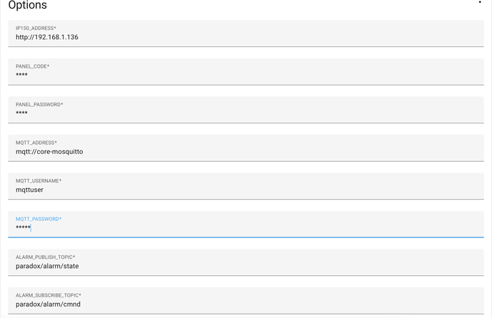

Hey team,
I am getting the following error when trying to connect this addon, have read above but that has not solved my issue.
mqttuser and password are correct, double checked a few times

File “ip150_mqtt.py”, line 140, in
ip_mqtt.loop_forever()
File “ip150_mqtt.py”, line 122, in loop_forever
self.ip.login(self._cfg[‘PANEL_CODE’], self._cfg[‘PANEL_PASSWORD’])
File “/ip150.py”, line 142, in login
raise Paradox_IP150_Error(
ip150.Paradox_IP150_Error: Wrong page fetcehd. Did you connect to the right server and port? Server returned:
Your Paradox System
Using the master password to login via the web no issues
Can login in with babyware and can confirm that panel password is correct also
Any help would be great.
Are you on v1.5 or earlier firmware?
Hi Scstraus,
Panel Firmware is 4.90
Ip module firmware 4.40.04
Wrong integration. See countless other forum posts in this thread redirecting to correct one.
