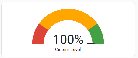

I was able to get this working - thanks to all who contributed!
I used the free api with a rest sensor
sensor:
  - platform: rest
    resource: http://192.168.0.120/config?json=true
    scan_interval: 120
    value_template: '{{ (value_json.tx_sensors | regex_findall_index("1\":(-?\d+\.?\d+)") | float - 10107) | multiply(0.0075103266992114) | round(0) }}'
    unit_of_measurement: "%"
and a gauge card
and an automation to alert me if the level drops below a certain percentage.

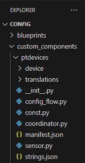

Hi everyone, I approached ParemTech about using a PTLevel device in HA and they actually have a Home Assistant integration that I have their permission to share with you all.
Initial steps:
  1. Open a ticket, request the ptdevices.zip file with the integration source code, and your API key. Let’s be kind and make it a low priority request so they don’t get bombarded.
Installation
  1. If you haven’t done so already, install the Studio Code Server add-on in Home Assistant.
  2. Once Studio Code is installed and running, open it from the left sidebar.
  3. When you open Studio Code, it should drop you into a VSCode environment in the “config” directory.
  4. If there isn’t already a “custom_components” folder, create one.
  5. On your computer, unzip the ptdevices.zip file.
  6. Drag and drop the unzipped “ptdevices” folder into the “custom_components” folder in Studio Code.
Make sure that the folder looks like the attached image.
  1. Restart Home Assistant.
  2. Add the PTDevices integration. The device and entities will then be exposed to HA.
Device ID is a 5 digit number in the URL, or the MAC address of the device.
