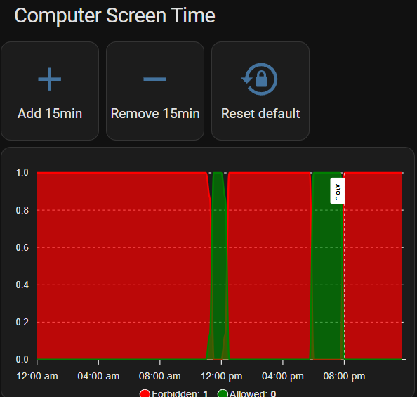

for some time I was looking for a integration of timekpr-nExT [ Timekpr-nExT README ] in home assistant to control the time of my kids on the Ubuntu computers. Because loging in ssh and editing the config file of timekpr is burdensome and my wife would not even give it a try.
so i have developped a set of scripts on the ubuntu devices that are called by ssh via home assistant.
since I’m not an expert nor a developper, I have used AI to help me coding, I’m sharing my work here so it can be reused and improved !
I have developped 3 scripts that control timekpr:
- Add 15min: the script take the current authorised period and add it 15min
- Remove 15min: the script take the current authorised period and remove it 15min
- Reset to default: set back the default allowed time

RESET to default
default time in the family is no time during weekday
18h-20h on Fridays and Saturdays
18h-19h30 on Sundays

Home Assistant Lovelace card
here is the card that I use
and here is the configuration for the card.
The card is conditional on the user ( I don’t want the kid to be able to grant himself more time.
I use a APEX chart (Looking for a better solution) that is refreshed every minutes

- type: custom:apexcharts-card
header:
title: KId1 Access Today
graph_span: 24h
card_mod:
style: |
ha-card {
height: 300px;
span:
start: day
now:
show: true
color: '#FFFFFF'
label: now
series:
- entity: sensor.kid1_allowed_minutes
type: area
color: red
stroke_width: 2
data_generator: |
const data = [];
const forbidden = entity.attributes.forbidden_minutes || [];
const today = new Date().toISOString().split('T')[0];
for (let block = 0; block < 96; block++) {
const startMinute = block * 15;
const blockMinutes = Array.from({length: 15}, (_, i) => startMinute + i);
const count = blockMinutes.filter(m => forbidden.includes(m)).length;
const hour = Math.floor(startMinute / 60).toString().padStart(2, '0');
const minute = (startMinute % 60).toString().padStart(2, '0');
const time = `${today}T${hour}:${minute}:00`;
data.push({ x: time, y: count / 15 });
return data;
- entity: sensor.daniel_allowed_minutes
type: area
color: green
stroke_width: 2
data_generator: |
const data = [];
const allowed = entity.attributes.allowed_minutes || [];
const count = blockMinutes.filter(m => allowed.includes(m)).length;
return data;
title: Computer Screen Time
