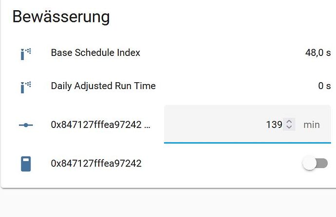

Hello, I have integrated my Parkside with Zigbee2mqtt. This means that switching off for 1 minute is no longer a problem. You can leave the valve open until the maximum time. I take over the opening times from Smart Irrigation and it works.
Now I still need the battery display. I read somewhere that it should work with Zigbee2mqtt and the change of a file. If anyone knows more or has this file, I would be very grateful for help.
