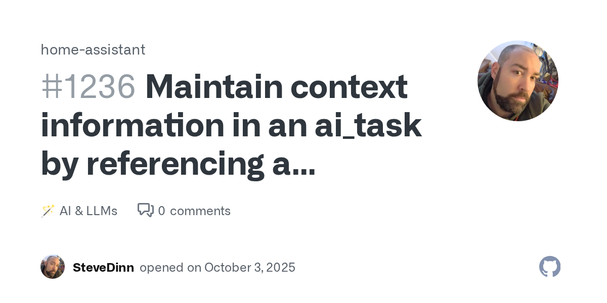

FYI, I started a discussion on the github page:
