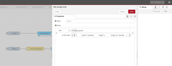

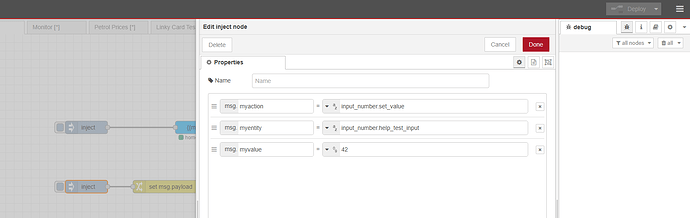

Step 1: have the settings available in fields in the message (example from an Inject node)
Step 2: use a Change node and JSONata (J:) to construct the JSON object for msg.payload
The JSONata expression… here all the Action node settings are being provided, and are all being generated from message fields.
Step 3: pass the msg.payload as input to the Action node, with the Block input overrides setting unchecked. The Action node now requires no input settings.
