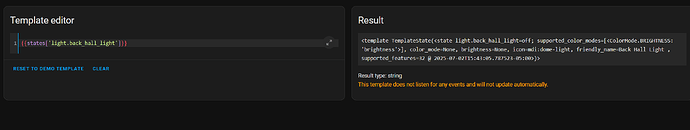

Are we sure the device id is passed in the entdump into context?
Im pretty sure it’s the net result of the ent list for each:
or clearer:
{{states['light.back_hall_light']}}
Results:
<template TemplateState(<state light.back_hall_light=off; supported_color_modes=[<ColorMode.BRIGHTNESS: 'brightness'>], color_mode=None, brightness=None, icon=mdi:dome-light, friendly_name=Back Hall Light , supported_features=32 @ 2025-07-02T15:43:05.787523-05:00>)>
Means LLM Context: (with alias data)
[alias, alias 1, alias_2]
See what’s NOT in there?
Hint…(no device ID) if the LLM hasn’t seen it in context or know how to get it - it DOES NOT exist. Im not sure It CAN without help… Maybe they added the device id in there but it’s not in the default expand. (honestly I haven’t checked, I havent needed to Im only checking on entity_id and Name or sometimes area… and a lot of label resolution, no devices.) You’ll need instructions and intent to resolve device id from entity_id first. (adds to todo list for Fridays entity resolver)
I’d be betting cash money it’s falling back to device name because it can figure out something resembling name… And so it gives it a shot.
